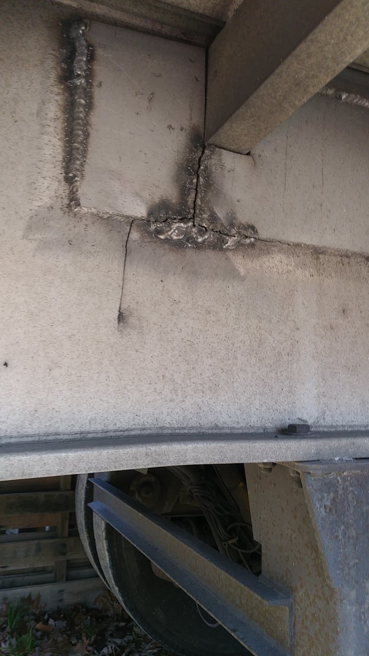

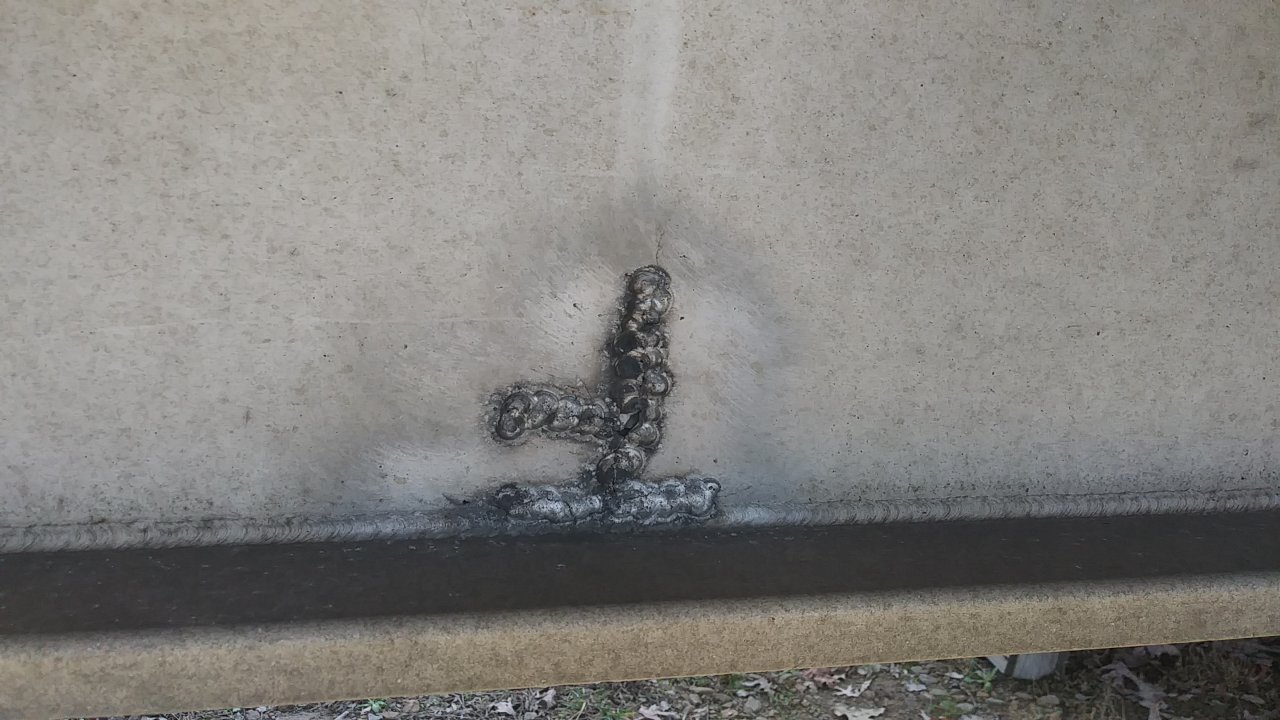

    I think theyre all ravens, former sidekit 48x102s probably from the later 90s or maybe 2000s. We have an east but i believe its steel combo.. The top dog got a newer trailer maybe 6 months ago ill have to glance at it. I got his ravens which is heavily plated. Another of ours was spool gun plated and that all popped off (because its a poor quality repair no matter how much cold wax you melt onto the plates) and the trailer is hard down until i go retrieve my tig from up north and fix it right.
    If you were looking north and the truck was parked in front of you headed east, they basically all start a stress crack in front of the forward spread mount diagonally upward.. from the corner where each frame rail is pierced for the crossmember to pass thru. That crack in the vertical frame plate travels southwest toward the forward axle pad until it terminates at the bottom flange and the trailer goes swayback. If its really bad, the crack will turn west and start peeling the vertical plane away from the flange which is obviously in tension under load and the deck will really plop down. The 5th wheel apron area is also prone to cracks of a similar nature, almost like fish gills.
    We are a quarry so our trailers are hammered when we get them and then we run 80k out of the woods thru waterbars, washouts, creeks and steep hollar switbacks, and deliver into super narrow suburban richieville stone retail yards on perfect grippy asphalt with no dumpvalves. (I put a manual dump on mine for emergencies but the other guys are SOL) anyhow its the fully loaded jackknifing the wrecks the neck of an aluminum trailer. They need to have the cracks drilled, vee'd out with a die grinder and filled with a high amp tig then maybe fishplated over after smoothing. Spool gunning it is just cosmetic, not repair. Spool gun fish plates pop right off the first time you flex the spread in the woods. Using up equipment is just a part of quarrying. I have welded steering boxes to frames and pitman arms to sector shafts in this line of work. Poor people and their poor ways gettin it done without any help from the dotgov.

  11. FoolsErrand
    FoolsErrand Road Train Member
    2,877
    12,169
    Sep 15, 2017
    This is our worst, ravens fleethawk or whatever. My coworkers [husband/wife] were being forced to pull it and complaining it needed fixed but boss kept gaffing them off. One day it was loaded at base while i was there and one of the cracks had spread to an inch apart, both rails about snap. I told them dont strap, went to boss and said if you send them out like that im gonna call DOT and have them meet you right here in the parking lot.
    The load came off and trailer is parked until i cut all that junk off and fix it right. Notice that every spool gun weld just cracks. The plates arent doing anything.
