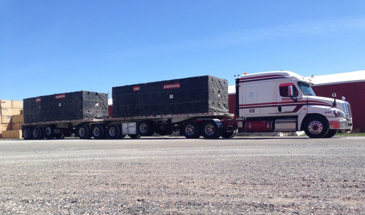

    Flatbedding comes with homework. This is your new bible. Read it, learn it, love it, live it.

    Chewy, that looks like a pain in the arse

    It was. Lots of lessons learned. No damage though. Broker even tried to file a claim on it but it got denied CAUSE THERE WAS NO DAMAGE. Stupid brokers.

    @Chewy352 I pulled alot of steel buildings wrapped up like that pipe. I found that pipe stakes help to mitigate most of the almost guaranteed failure of the wood holding the bundles together. how that would work in a covered wagon though I don't know.

    Thx for the pic. I've never even seen something like that on the road. How does that pull uphill in the winter? You're tougher than me.
