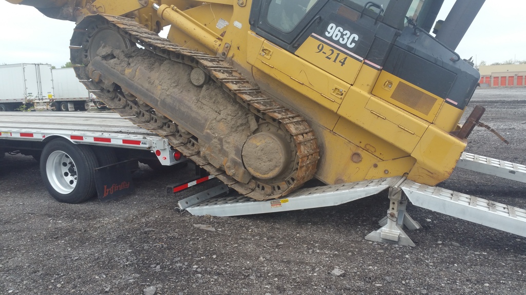

    That's insane... kinda curious what caused the failure and if the manufacturer warranted the repair.
    Why would they be fired? The trailer is what failed. Ramps didnt.

    They should be fired for extreme lack of commonsense. The trailer was obviously not fabricated adequately to handle something like that and the person loading knew it.
    Those ramps are rated for around 20,000lb +/- per axle. That machine was around 40,000 or so. Yes weight wise the ramps themselves were close to rated capacity, but what fools like that dont consider is the amount of stress put on them, the pins and the back of the trailer itself when the machine is pulling itself up the incline.
    Just because it says max capacity on a ramp like that doesn't mean you should temp fate with a $100k machine to see what will happen at max capacity. That's just stupid as hell. Especially a track machine on aluminum ramps.

    Makes sense. Weight is 41.9k according to CAT, so depending on if the ramps were 20k or 23k that would be on the driver.
    But how would a driver or even an owner know what the manufacturers weight rating for the end cap? I know that they rate gross, and sections(4ft, 10ft, etc for coils and such). But I've never heard of end cap rating. Seems like that would be an "eventually it will break, but we have no idea when" kind of thing. Especially if the ramp hangers were mounted at the dealership, then there seems to be no other explanation, other than the cap failed where it shouldnt have. Right?
