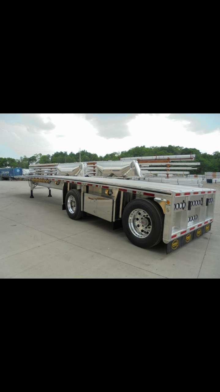

    So far you have put together a decent trailer.
    I would agree with the others, that you definitely need a load gauge and a dunnage rack.
    Spread axle is most assuredly the way to go. I would have the boxes mounted between the spread on each side like I had on my East.
    I would skip the super singles. They may be lighter, but they have very poor footing in the winter, and your dead in the water if you ever blow one.
    Since flatbed loads are so diversified, you could get into a hairy situation if you ever blow one.
    The sliding winches are very nice. I had 15 on each side. You can move them wherever you need to, and if you run short, which you will from time to time when you get those Jenga puzzle type loads, make sure to get about a dozen rat clips for the outer track. They work great when you need to add a few 2".
    Dump valves are also a must on flatbed.
    I also had the oversize package. Flip a switch on the back of the trailer changes the amber lights to flashers. That's up to you. Had it on the trailer, but only used it 3 times in 5 years. Oversize pay well, but are not always easy to come by, especially ones that want to pay well.
