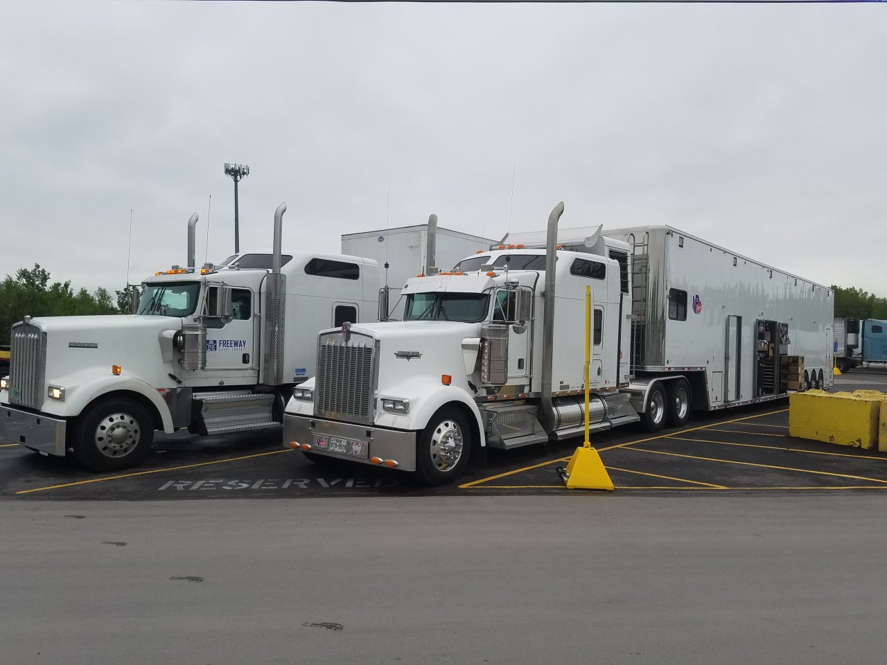

    What's your 20, hand? And if you don't mind, could you post a pic of that 295wb W9?

    I’m.Also here for a picture of your truck

    She looks just fine to me! Looks like ya got a friendly watchdog there too.
    Have you found an open deck company willing to lease you on?

    The company I'm with has a few open decks. Mostly vans.
    Yea shes my shotgun buddy.

    Nice. That ride looks like it was made to pull open deck.

    I'm liking the air cans on the left front of firewall. You would think there is one on the other side as well....
