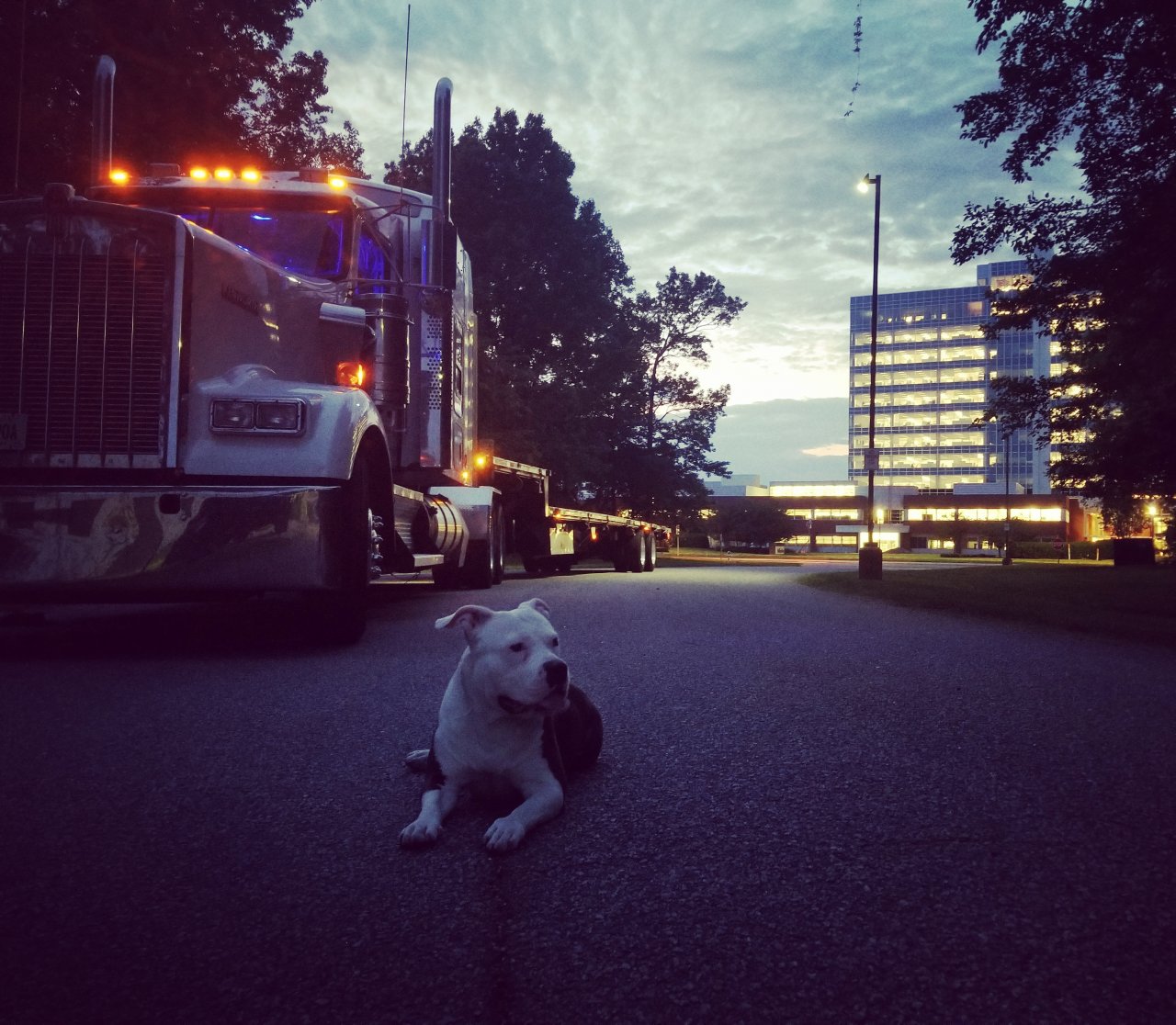

    Just wanted to give you guys an update.
    About a month and a half ago I bought a 2013 step deck. Didnt have the money for an all aluminum, and I got a decent deal on a combo.
    Been running for about 3 weeks now, and this heffer is heavy... lol
    I can only get 44k before I'm closing in on my 80k. However, my mpg is up around 1, to 6.5mpg. I'm running shorter miles, and loving the exercise. Icing on the cake is the cool things I get to haul. Securement is easy so far, haven't tarped yet(ones I got with the trailer were trash), but everything is going well.
    I have noticed how little the majority of the brokers care or know about this side of the industry. I get quoted all the time 1.50 to 1.80 a mile, and it's hard not to laugh... when does the peak seasons usually run? IMG_20190508_224131_975.jpg

    You get the step freight figured out, you will like it, They are heavier, BUT you will make more hauling lighter freight anyway. I, even on my flat I seldom ever took max loads, steel, lumber etc was to cheap and I hated dealing with a steel mill, period.
    I had risers for my step, so I could haul some stuff, but eventually quit carrying them, unless I was on a pipe haul.
    The last several years I ran down there I did not even carry tarps for the most part, just didn't take any freight that required them, I did carry a couple of smaller ones, smoke tarps actually, but they had enough d rings to work with some ltl stuff that had small items that needed tarped.
    I have a w9 similar to yours, white and 310 inch, but flat top and rigged a bit different, great trucks.
