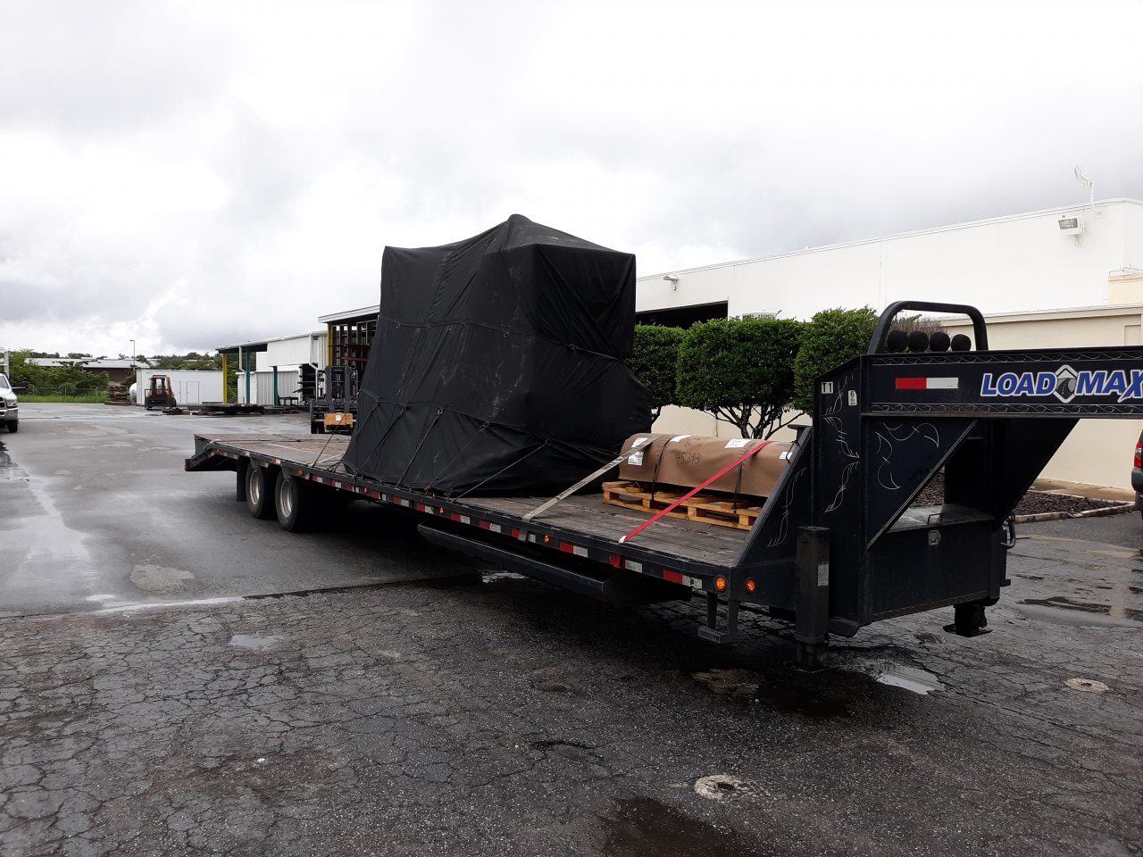

    I may get flamed for this, but depending just how light & long your talking about a 40' hotshot could work for your application? Them goosenecks have no camber at all. You will need to specify air ride too if your freight is that sensitive I think..

    If a class 8 flatbed is perfectly flat it’s a junk old trailer. It has to have arch to it so that when it’s loaded it goes to level. If it’s level to start out it will have negative arch when loaded and that’s not good. Arch is important enough that most trailer manufacturers can “re-arch” old trailers so they’re still useful.
    Why can’t it go in a dry van? That’s about your only hope of finding a flat trailer without hiring a hotshot. Otherwise you’ll have to block and brace on a flatbed to make a flat loading surface.
