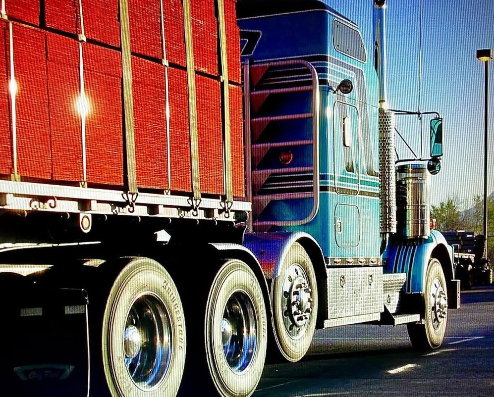

    Weld rope hooks under the rail. I used to pull Western flats and they have no rub rail. Rope hooks also allow you to use stretch cord or rope in your tarps instead of 1000 bungees.
    Oxbow, singlescrewshaker and cke Thank this.
  7. Long FLD
    Long FLD Road Train Member
    13,033
    54,699
    Mar 4, 2015
    You can see our rope hooks under the deck.
