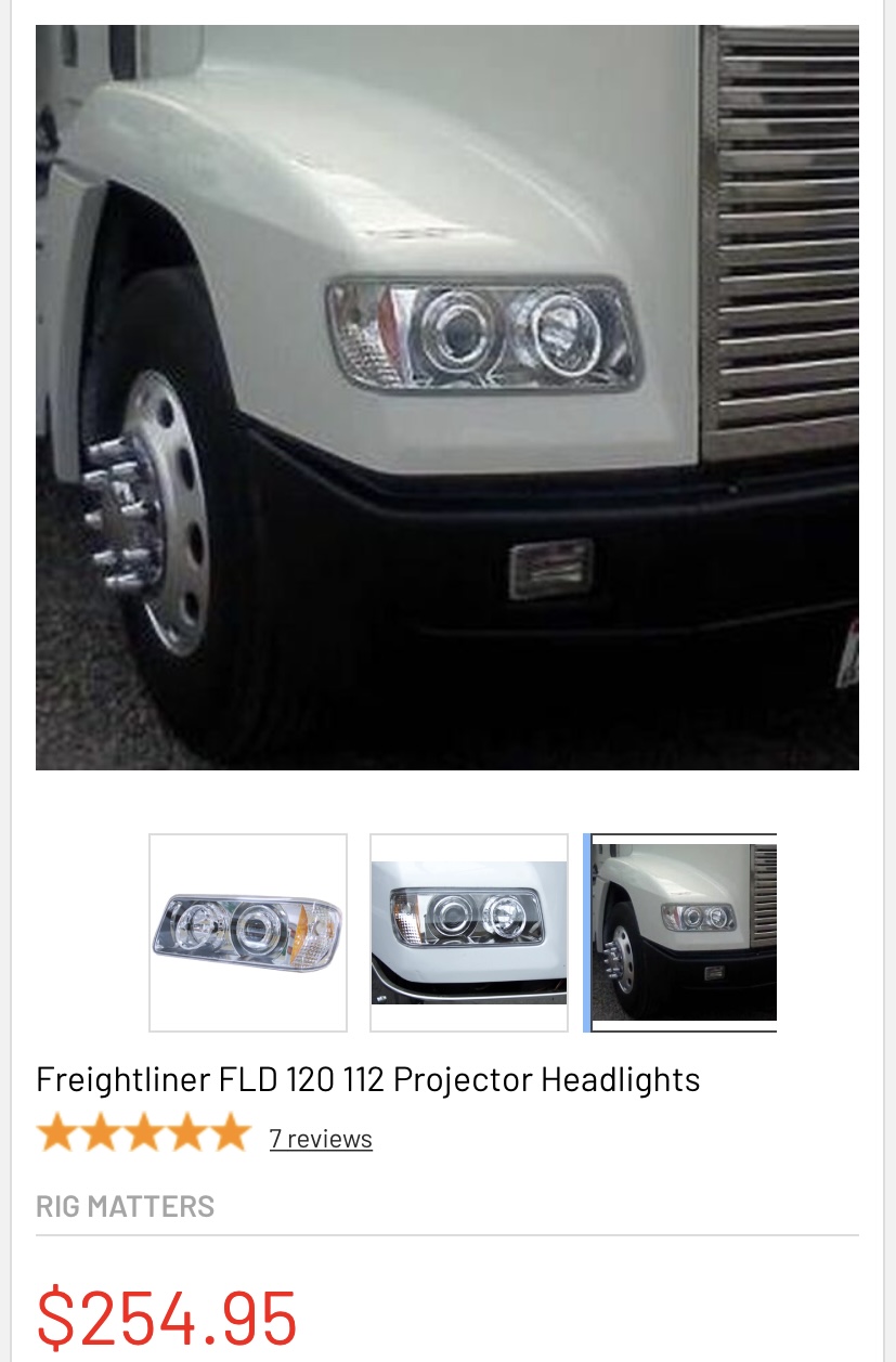

    Get some that are heated. Upgrading headlights is more than worth the money. You may have to modify the headlight bucket to get the wiring to fit behind the lights.
    Or you could buy the projector lights that replace the bucket and all.
