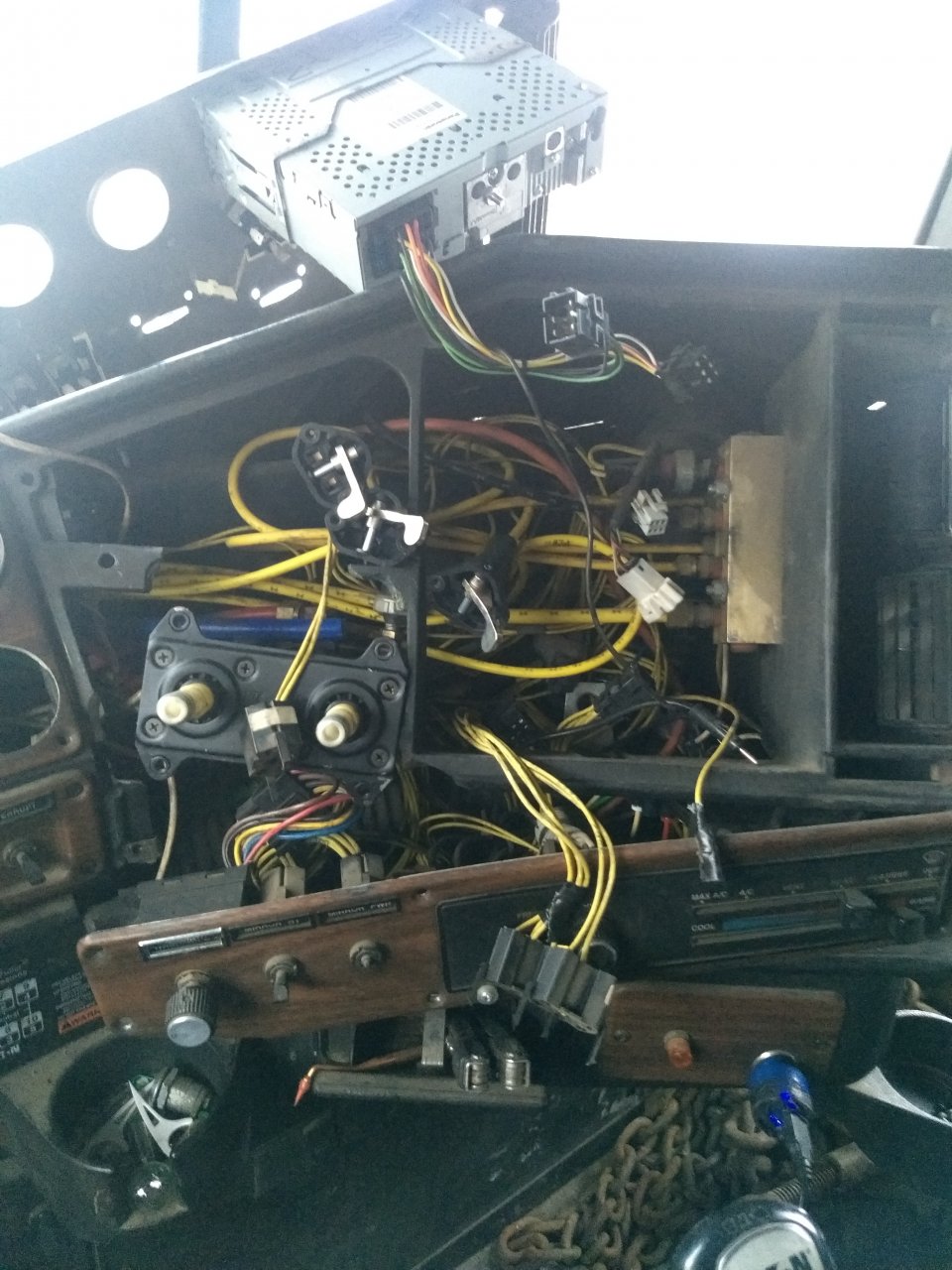

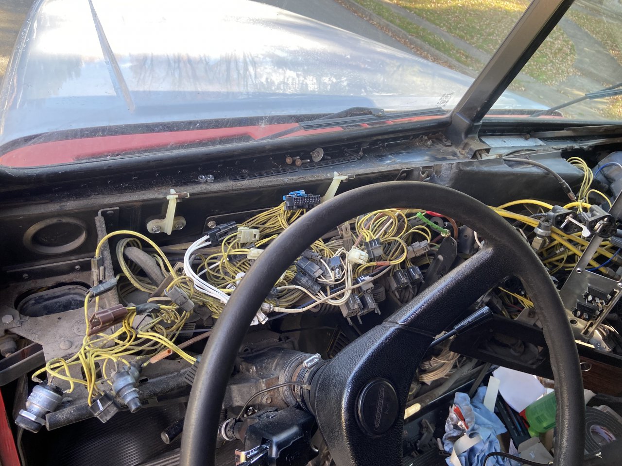

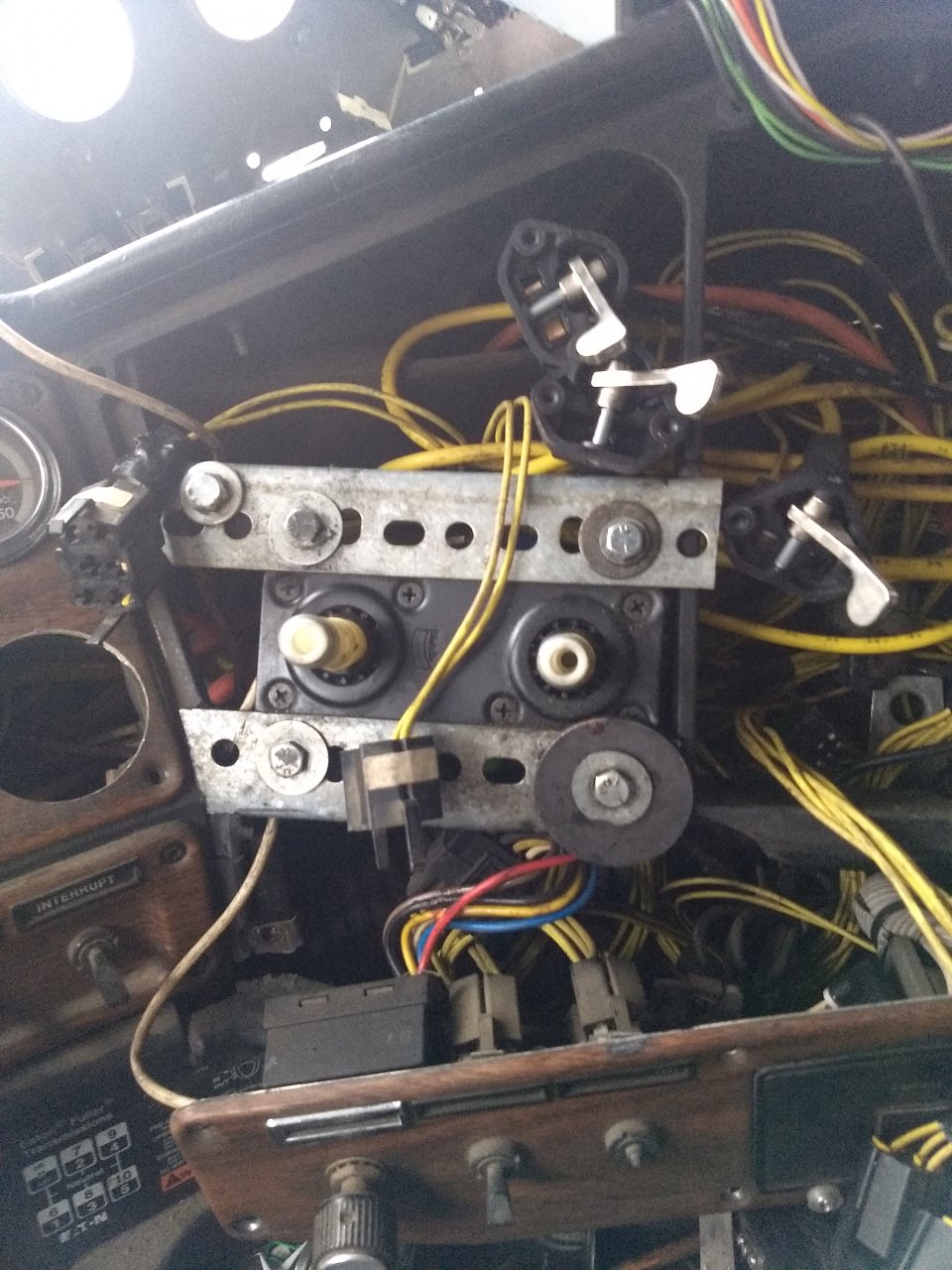

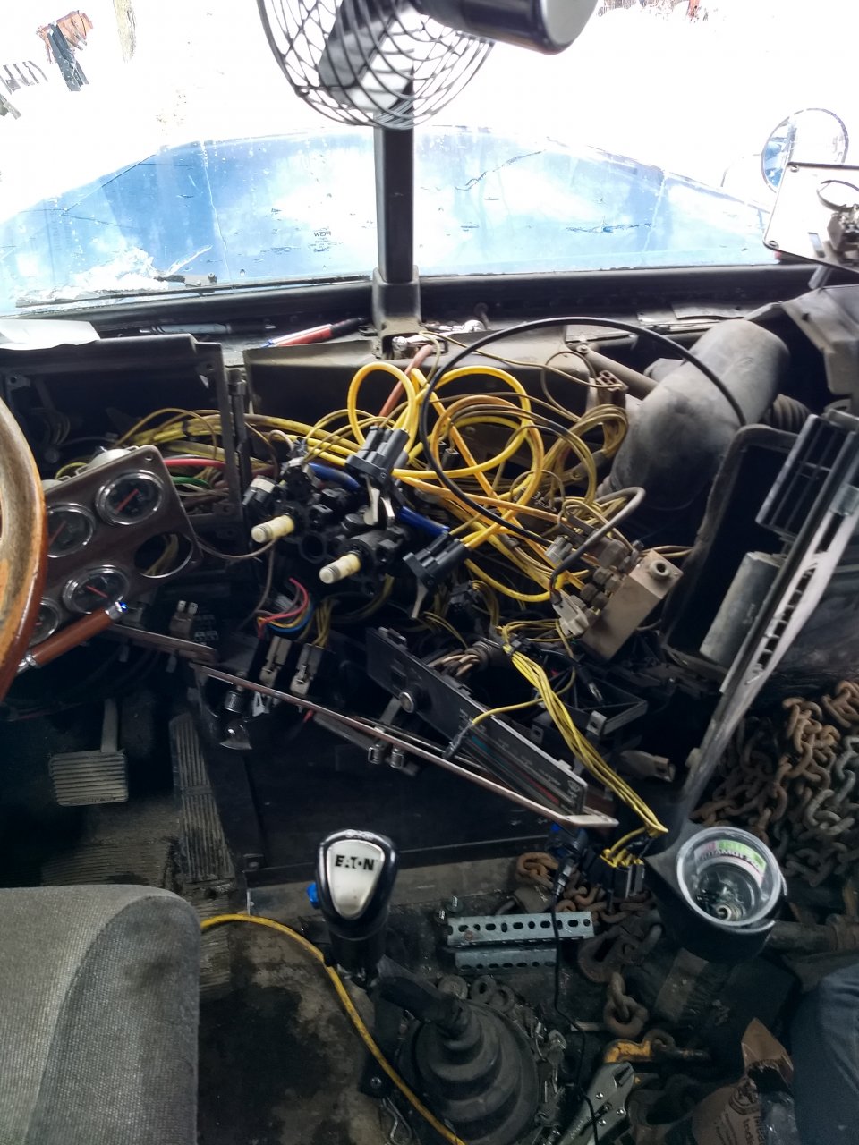

    Easy to replace once you get access. Good luck IMG_20200215_132642118_HDR.jpg IMG_20200212_161238199.jpg
    Not as bad as the pictures look. I had to replace the internal dash frame.

    I need to replace my frame. I replaced my dash valve 3 times. Last time for some reason had a real hard time. Threw my back out. 8 yrs later, it’s still not right. Broke the frame also. I’d like to mount it differently, so it’s easily changed without taking anything apart. Seems so simple to do. Drill a few holes, surface mount it, with a plate to cover it all.
