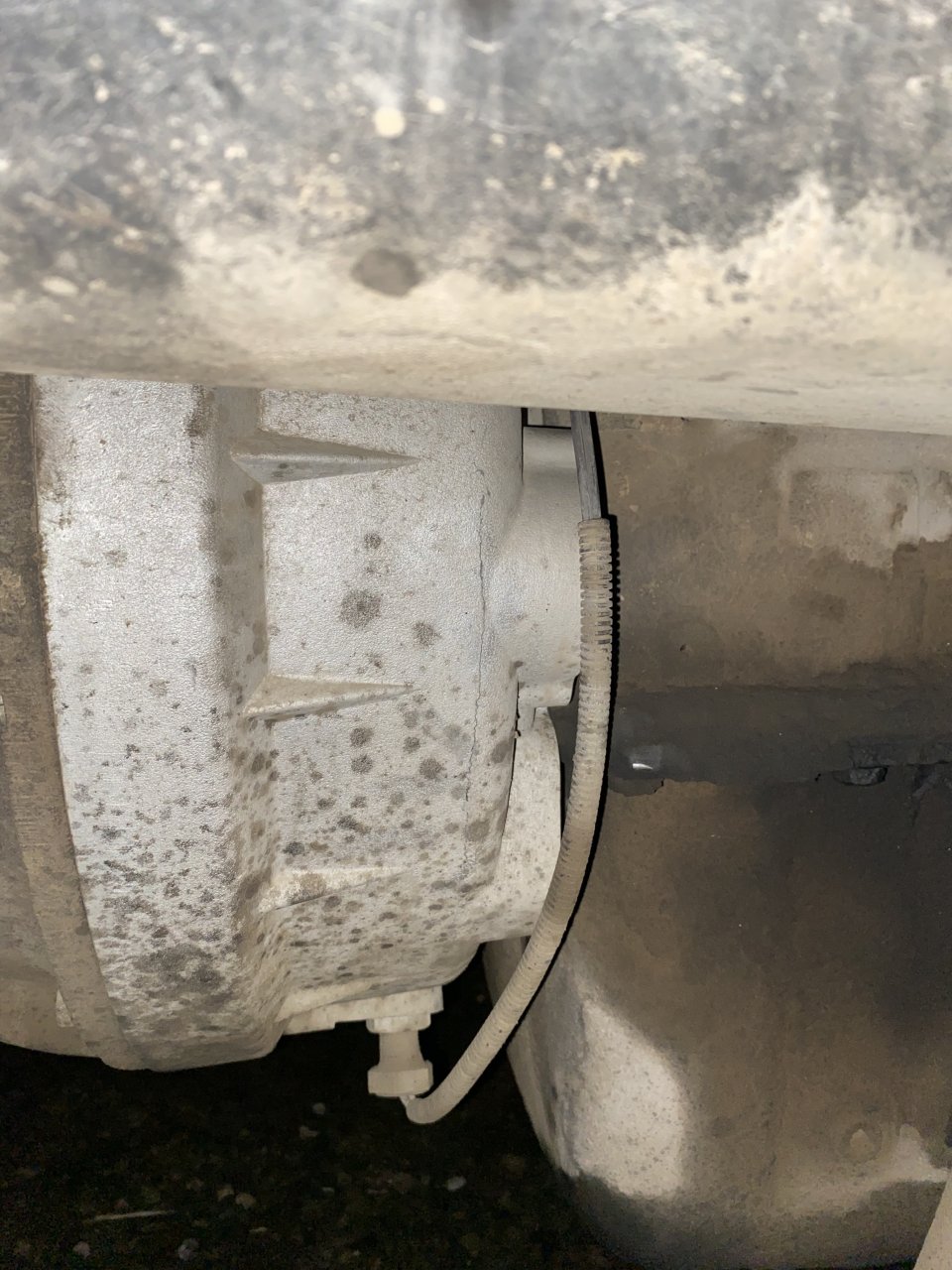

    Do you have a pic? Where does the crack start?

    It’s cracked on the passenger side going up& down. It has cracked in the same spot on all housings.
