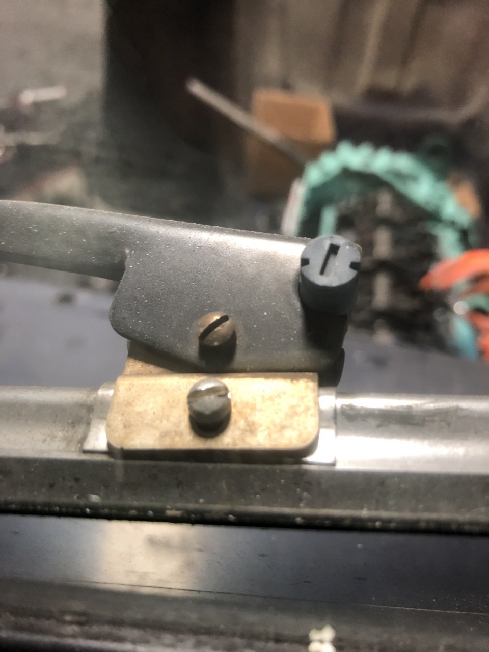

    D93A14E8-76B6-43F7-A242-D0EB7E84B466.jpeg Wipers part Alliance # 82-7115 I think they’re the longer ones. Here’s a pic of installed

    I drilled out the hole on the wiper arm, and now i can use any 18" blade i want from wally world. When you get the blade, take a pair of side cutters and snip the little cross bars in the middle. You'll see what im talking about. Presto. Any blade you want. When u drill out the arm, use a phillips bolt with a lock nut
