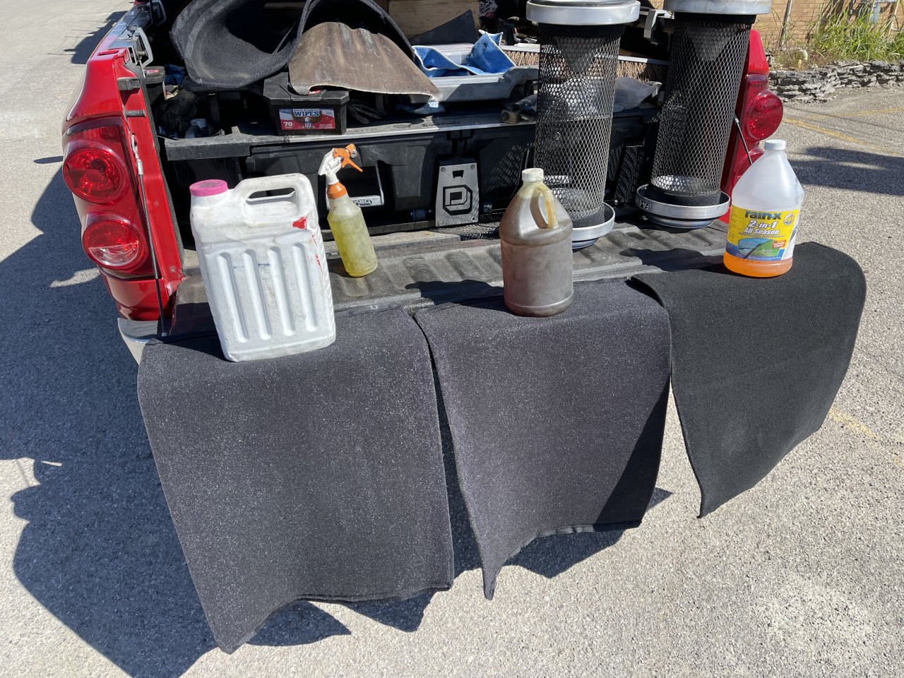

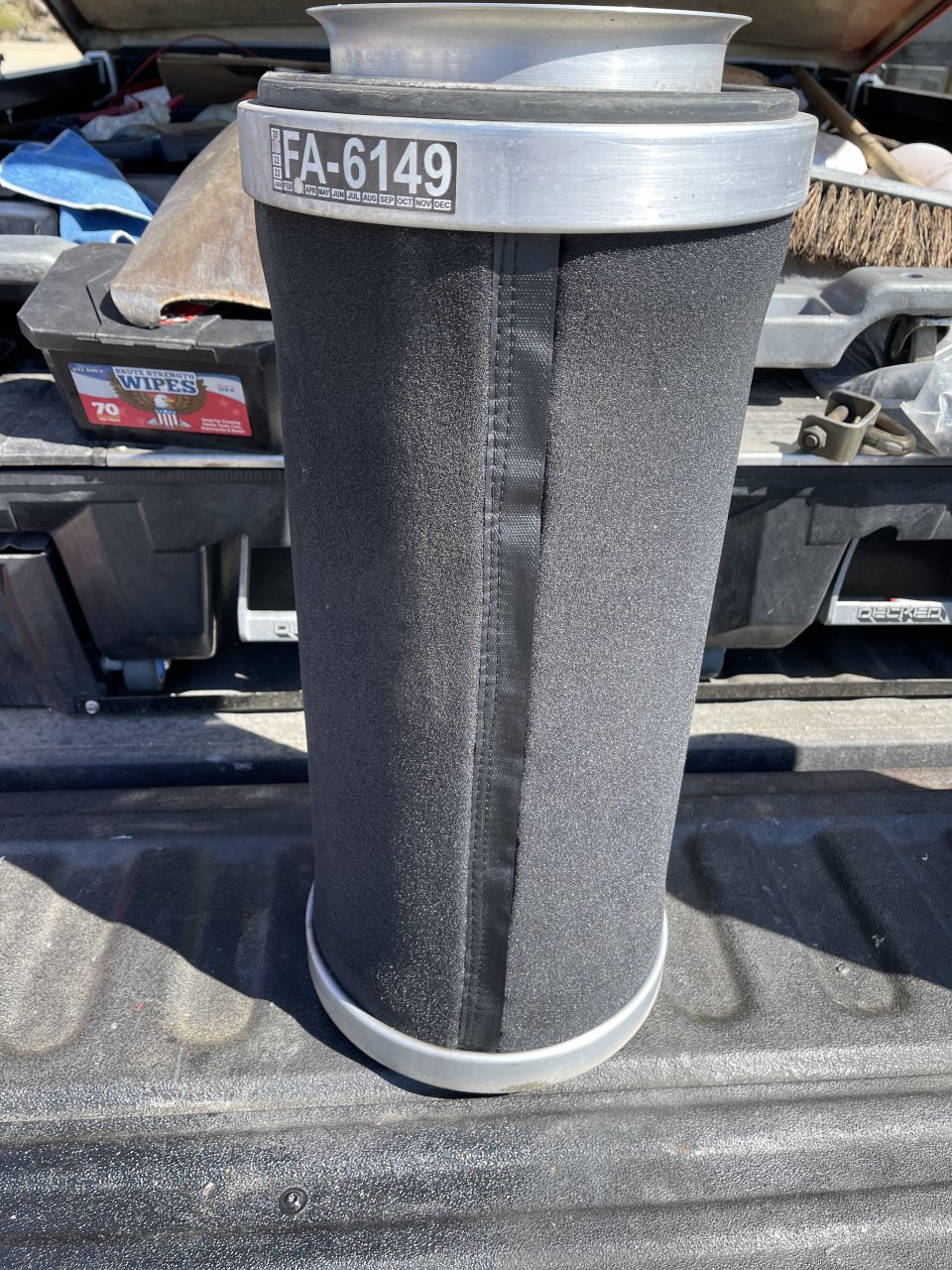

    This is the outer layer after 6 months of use. I work in a very clean environment so twice a year cleaning is enough. The inner layer was reasonably dirty but the middle and outer layers looked like they hadn’t been used. I cleaned them at the truck today since it was a nice day and they air dried in 30 minutes or so. 59C46B0F-781B-4131-80AE-7A1C55FD628A.jpeg 72514AEE-E8F3-47D1-8E36-43BD5E9FA894.jpeg
    Siinman Thanks this.

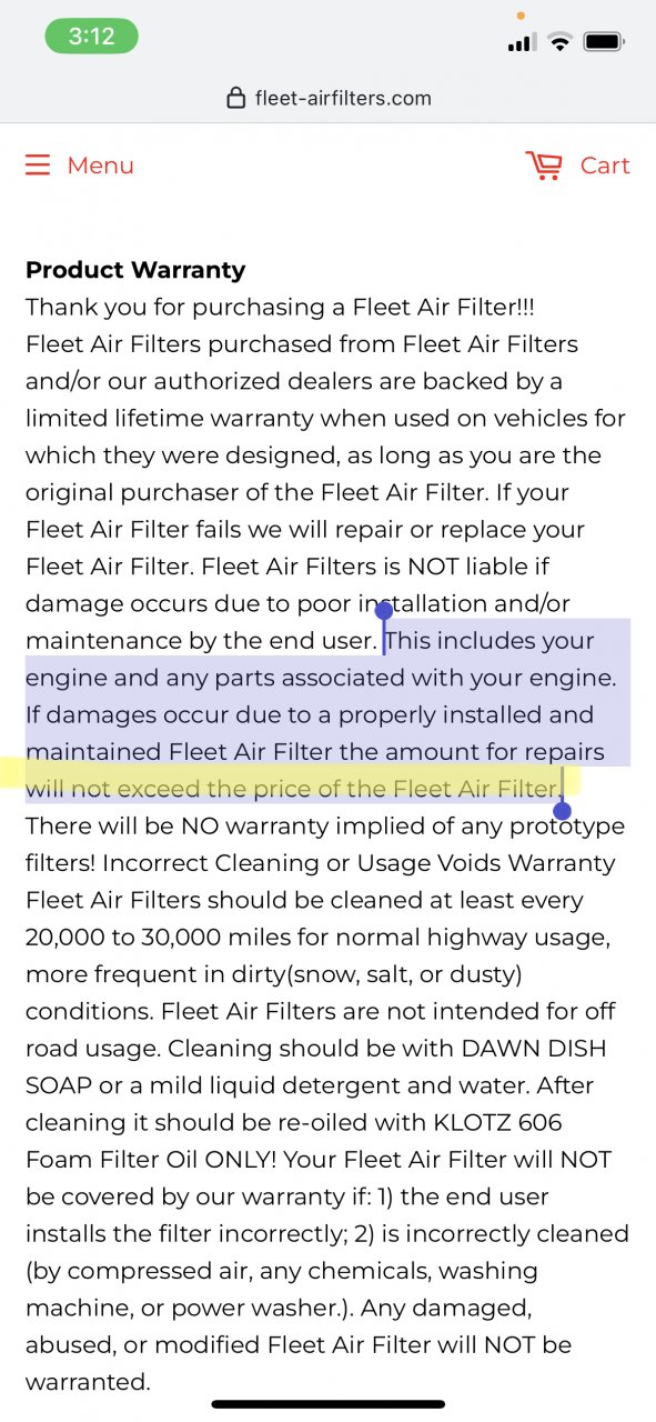

    This is all you need to know... when this filter dusts your engine, they are only liable for the cost of the filter. Call them and ask what the micron rating for their filters are.
    IH9300SBA, retlow8 and MartinFromBC Thank this.

    Maybe you can explain your thoughts further? I am under the impression that the presence of clean on the outside of the filter means clean air is going in the motor. I am not trying to be sarcastic, but looking for you to explain further.
