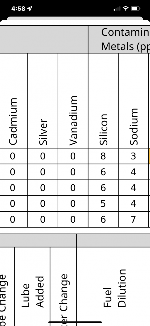

    Would what you are referring to be the silicon category? If so this category has never been flagged as elevated by my oil analysis on my motor. E06CD2DB-1E5B-4AA7-9C7F-D132CDC56CCF.png

    yes I meant silicon. this stupid iPad changes it when it is posted and I usually go back and edit and correct typos that it creates.

    I have heard it both ways, but wasn’t certain it was the same.
