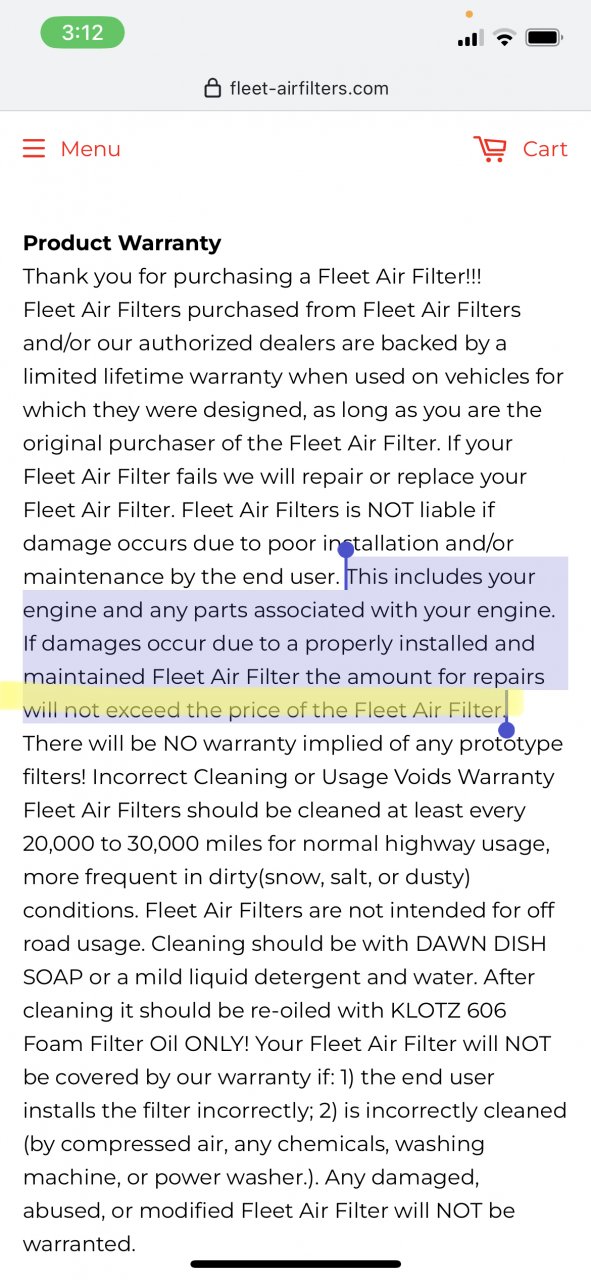

    You are correct, Sir. Ran their filter from around 1000 miles on the truck. My engine is now dusted out at 380k. They are denying any wrongdoing or failure from their underperforming filter. 2018 Cummins X15.
    For all fyi the T680 filter is just a piece of foam. Junk.
