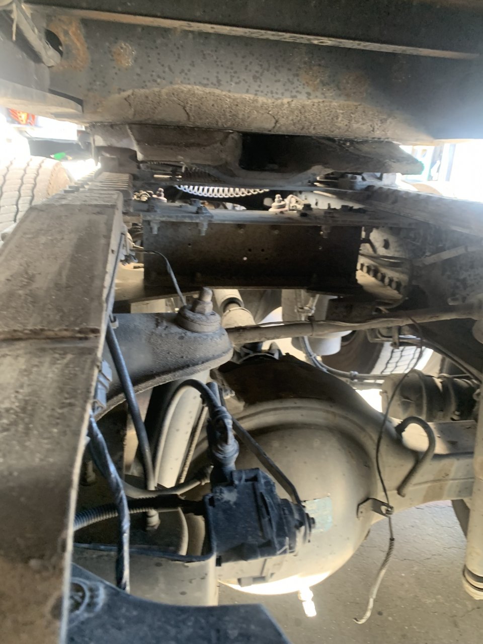

    cutting that thin crossmember out in the fifth wheel slide was one of the first things I did.

  5. AFC
    AFC Heavy Load Member
    889
    1,177
    Jan 1, 2024
    What is it for? I have a grinder and cut it easily. Any idea what’s it’s purpose?

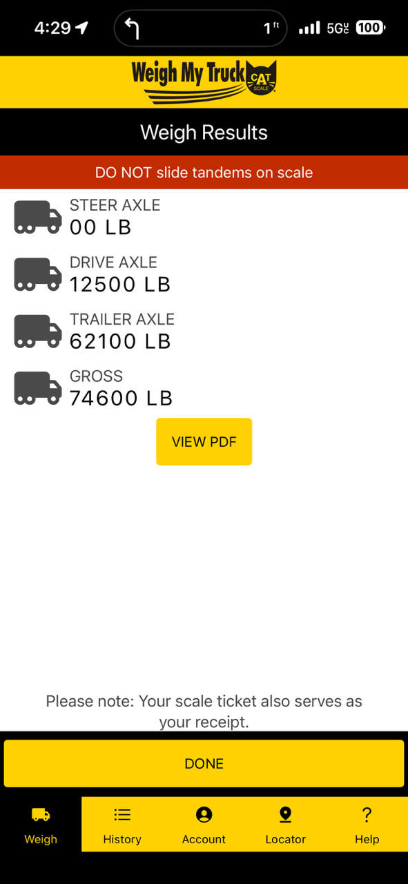

    You guys were completely right that I wouldn’t have any weight transferred to my steers. I will have to get the block removed on home time. Money is too tight to update the ramps for now. Attached are my scale tickets. I went thru one weigh station and they weighed me but let me pass. Glad for that and I will not disclose what state gave me the break. I picked up this load in Virginia and taking it to Texas.
    I have my lift axle at 90 psi. I will drop that to 70 maybe that will transfer some of the weight to my steers. IMG_9396.png IMG_9397.png

    When @ElmerFudpucker said that this Kenworth is too much truck for that trailer, I think he was suggesting that you will not be able to make full use of the truck. You might think that at least the truck is built for any weight that you are going to put on that trailer, and it certainly will, but it is so heavy ( I assume) that you penalize your self on what you can permit.
    Different application and different laws in different states, but last week I hauled a 90k excavator on a 50 ton RGN and grossed about 132k. My tractor would be considered a light heavy haul tractor I suppose. It started life as a logging truck, has an 18 speed and 2 speed 46k rears, and a light tag axle but just a 12k steer.
    The point behind this is that matching your equipment in order to maximize what you can haul is really important. Your situation makes me wonder if you could lose the drop axle, be able to put weight on the steer, and save 2000 pounds or so on your tare. Probably won't work, but an interesting thought.
