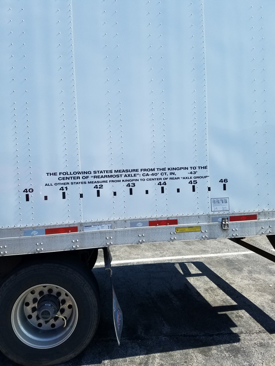

    Nine feet from the rear of a 53' trailer
    GGE Thanks this.

    It’s all in a commercial vehicle atlas
    Numb, GGE, Rollr4872 and 1 other person Thank this.

    Get a Rand McNally truck atlas. It has all the kingpin rules for each state. It’s not really worth fighting the ticket because your driver was in the wrong.

    That's a great example, I am not familiar with the citation the OP's driver got. I have seen drivers rolling down the highway with the tandems slid all the way to the rear. They get a citation for being too long under the bridge law
    GGE Thanks this.

    It’s not a bridge law, bridge laws deal with weight. It’s a KPRA regulation. Florida sells an annual permit for trailers that can’t meet the KPRA (stationary axles for example). I had to buy one every year for the 52ft spread axle cattle trailer I pulled.
