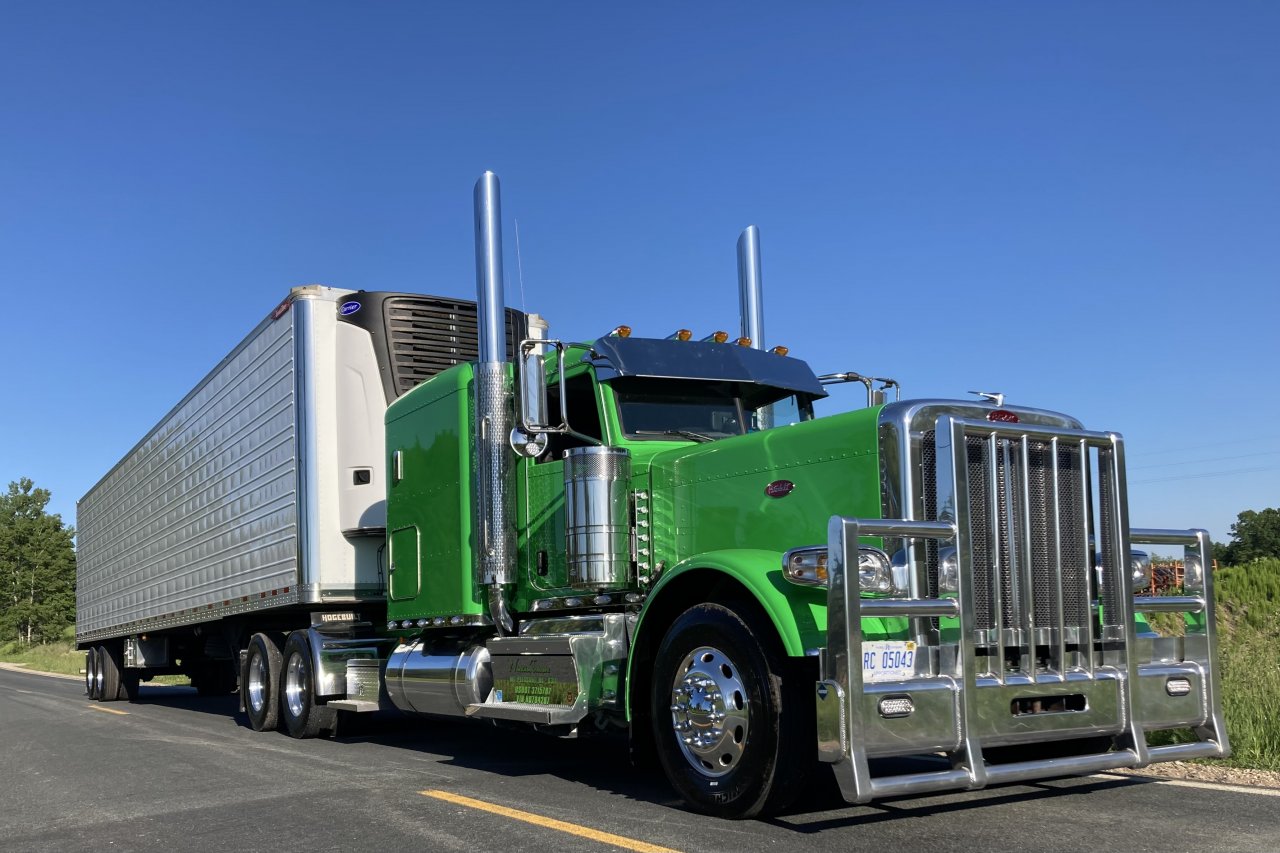

    362F21A0-630C-4C5D-BD5F-CACDF795ECC1.jpeg Just spent 2300 on detail and polish of truck and trailer. Increased fuel economy by 0% :( but morale gain was 10% a mile!
