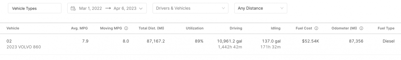

    Well I finished this load out and back home now. I had really high hopes for the load coming back home. I left Texas and was 9.3 MPG's and parked for the night. Next day hit wind yet again and killed my hopes and dreams. Was only 8.5 MPG's on the way back fighting the wind was frustrating. Total trip was 8.2 MPG's so not bad but I expected to be better. I did not see any improvement based off of the wind issues but felt the the trailer did for better handling.

    That is pretty good doing those weights. How many miles a week are they running? I am at 7.9 MPG's life time on this truck right now. Will start going up now that it is warming up.
