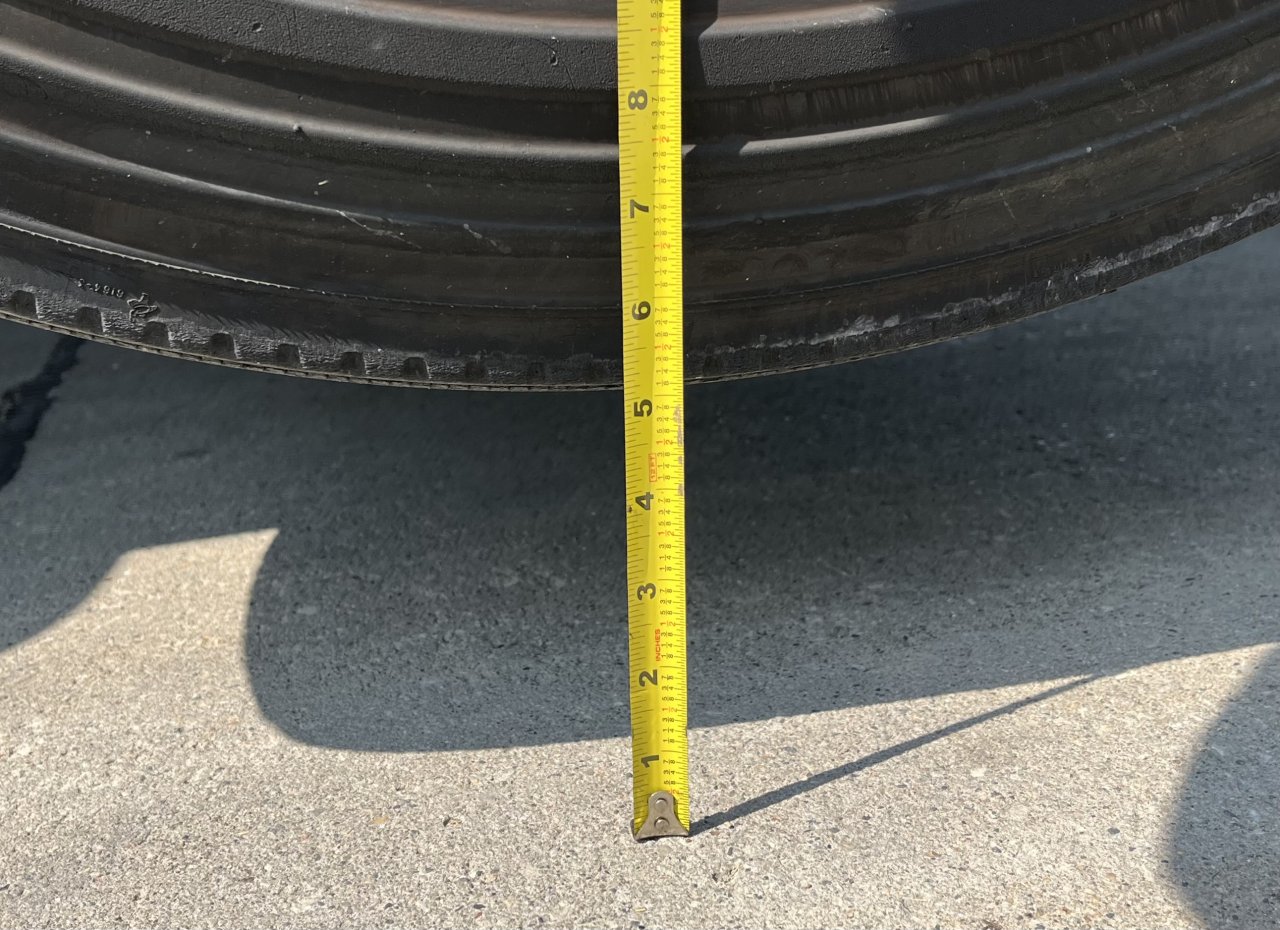

    Well got the lift axle installed and it is up about 3" off the ground. Fill a little better about it and also can gain another 1/2-1" if need to if this does not work great.
    Got loaded in MO and went to IN last night and got unloaded a few minutes ago. This load was 13,500 and ran the whole way with the lift axle up. Took 36 across so ran 65 on that road and then ran 67 when in the 70 Mph zones. I ended up getting 9.3 MPG on this trip so seems to be doing what it should be doing. Considering I did not do anything special on driving just hit cruise control and let it go. Also hit some decent wind during this drive but nothing that was bad.
    So I ran very similar to how I normally run just a little different route. I did have a few little bumps on the tires but nothing that will hurt them so I am pretty happy. I went over some pretty rough areas so I fill pretty good about the set up. I also put on new shocks when I had them add the lift axle and align both axles. Back axle was just a little out but not to bad.
    I booked another lighter load from IN going to MA that is only 7500 lbs. Will be interesting to see what this one can do with the lift axle. I plan on going on I90 and want to see if I get a little discount with the lift axle on the toll road. Really just took this load for experimenting more than anything. Pays decent but I know that area sucks right now but wanted to do a few tests before I got to far into this set up.

    Here’s one of ours with the factory lift.

    Mine is about 2.75-3" I believe without using a tape. It does seem to do just fine but will watch probably not be able to put as much weight as you can.
