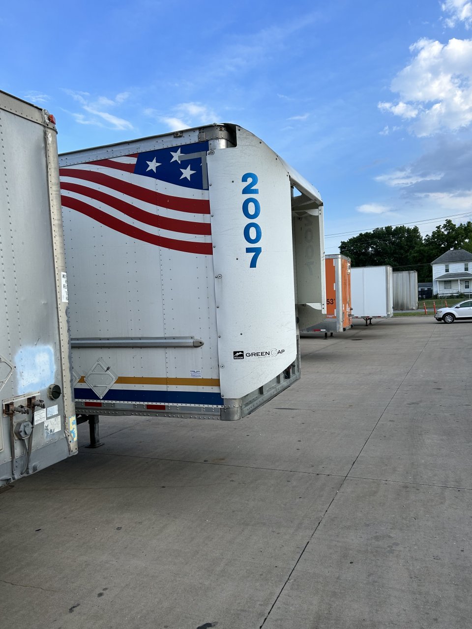

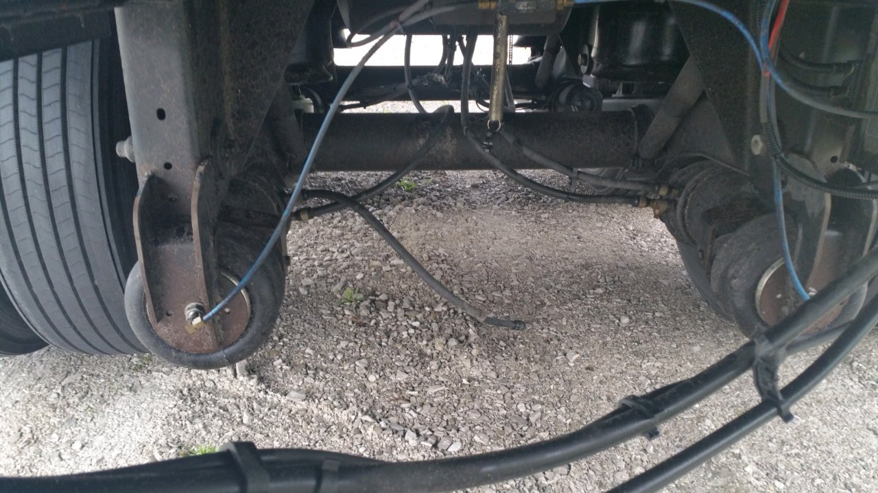

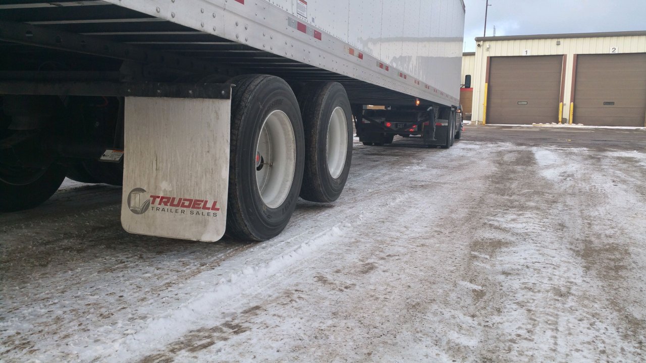

    I found some pics in my gmail storage of my lift axle right after it was installed. The only ones I have. I posted better ones in a thread here about 7 years ago but can't find it.

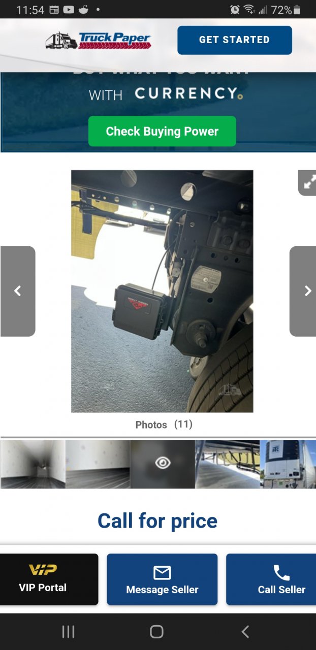

    Yeah it's basically the same. I had them install a suspension air gauge on mine at the same time. They put that gauge and the control valve for the lift in a little box like in the pic below except for my box was mounted a little higher and directly to the left of the air slider valve. Some drivers have that control valve in the cab which comes in handy for toll roads even if heavy you can raise it up at the toll booths and pay a cheaper rate then set it back down to the ground on the other side lol

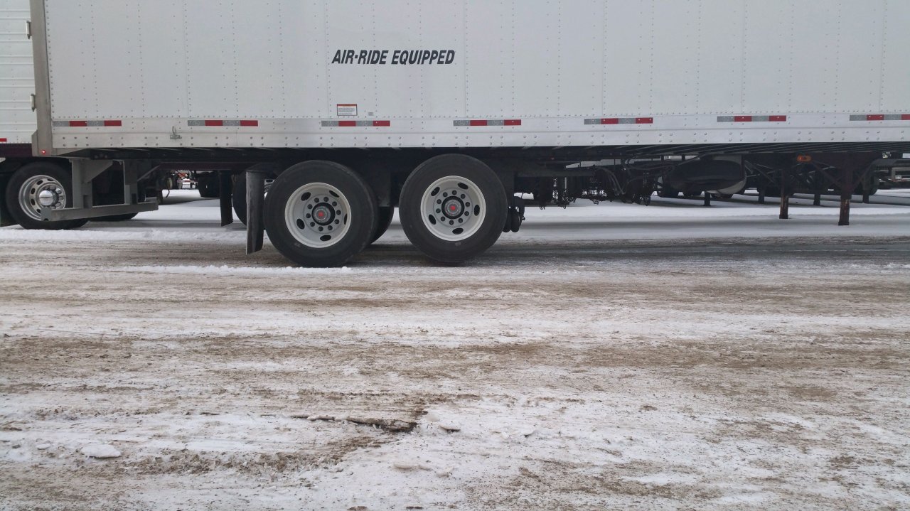

    Saw a couple dropped trailers with these on them and thought of you. Doesn’t appear they’re available, anymore.
