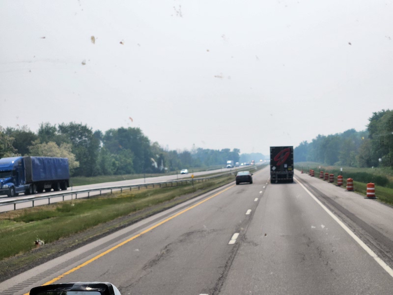

    This was yesterday afternoon on the thruway west of Buffalo. Heard it was worse farther east. When I got out of my truck to move around lunchtime, it was like someone was burning a woodpile next door, not north of Montreal 400+ miles away.

    Yep I was around all that area and it was pretty bad mainly in the afternoon. Thought it was fog when I first got around that area and then smelled it. I finally got out of that area and now stopped right outside of Indianapolis, IN. Need to find something going back home or out west. I may just dead head home if nothing pops up worth a sheet.
