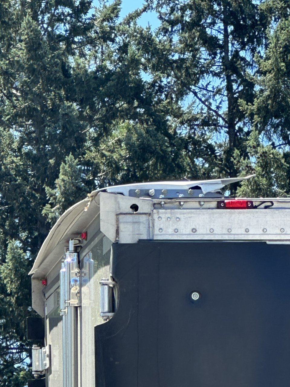

    Figured out why my MPG's has been down this trip but not sure when it happened. The Aero Top Cap on the trailer came loose and was acting like a parachute. So I went to Home Depot today and got some Metal Tap and Double sided tape. Got my ladder up in the 105 Degree heat and managed to clean and tape it all down.
    Seen when they installed the top plate that they only had 5 pieces of 2" tape across the whole width of the trailer. Thought no wonder I see trailers with these on always flopping around. I think my fix will work for awhile but will be keeping a better eye on it in the future. Only way I was able to tell is I was up on a hill away from the trailer and seen it sticking up in the middle. The sides was still down when stopped so it was hard to see unless was driving and someone said something.
    I have about 250 miles left to deliver his load and it is setting at 8.8 MPG and 8.7 MPG for the total trip. Have a load booked now from TX to OK with two drops. Prob will not get unloaded fast enough to get another load for Wednesday but will see.
    After driving today and yesterday it was pretty easy to see how bad that Top Cap was. IMG_1261.JPG

    Get some EternaBond tape and the spray primer that goes with it. Maybe some 3M VHB tape under the lip too, for good measure. Neither are cheap but they will stay stuck, provided you carefully prep the mating surfaces.

    I put some expensive 3M VHB tape for Metal and plastic under it and also bought some High/Low Temp Alum Tape that is impossible to get off. It will not move unless ripped off now and should be good for winter as well. Cost about $60 for both and have enough to do it again if ever need be.
