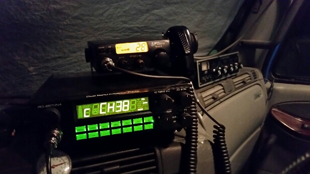

    The "radio shack"...

    By the way @mike5511 ... that's the MFJ941D in its new home.

    That's a nice looking SRA 198 hook up to it .

    On my General Lee, I feel like I get a better sound with my astatic 636 than my ranger sra.

    Well is it doing what you wanted it to? Nice set-up by the way!

    I like the sound of the Astatic better too. There is a 636L hooked to the N4 just out of frame. I just had the 198 laying around and it sounds way better than the stock Cobra mic.

    Why do you have a tuner in a mobile for one narrow band?

    I'm not sure yet. I'm knee deep in antenna theory right now and only have a basic understanding of how it is supposed to work.
    I did hook it to a fiberglass antenna that was way out of tune and then put my AA-54 on the other end to see what the knobs would do... not exactly like I thought. Maybe the inductor is a little crusty but there only seems to be one position that makes a big change and moves the resonance up in frequency a couple mhz. Or maybe I just don't know what I'm doing yet, lol.
    It did help me diagnose a low power output on my N4 which I was unaware of. The fuse had loosened up and wasn't supplying enough current to the radio to operate at full power.
    All in all, I'm happy to have more gadgets to tinker with.
