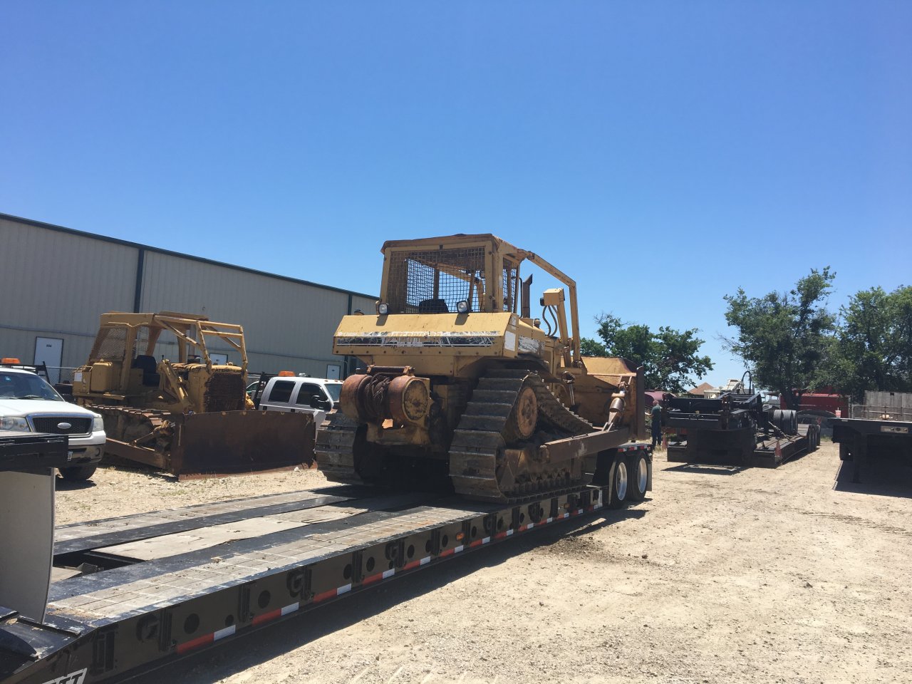

    Here is a pic of the trailer

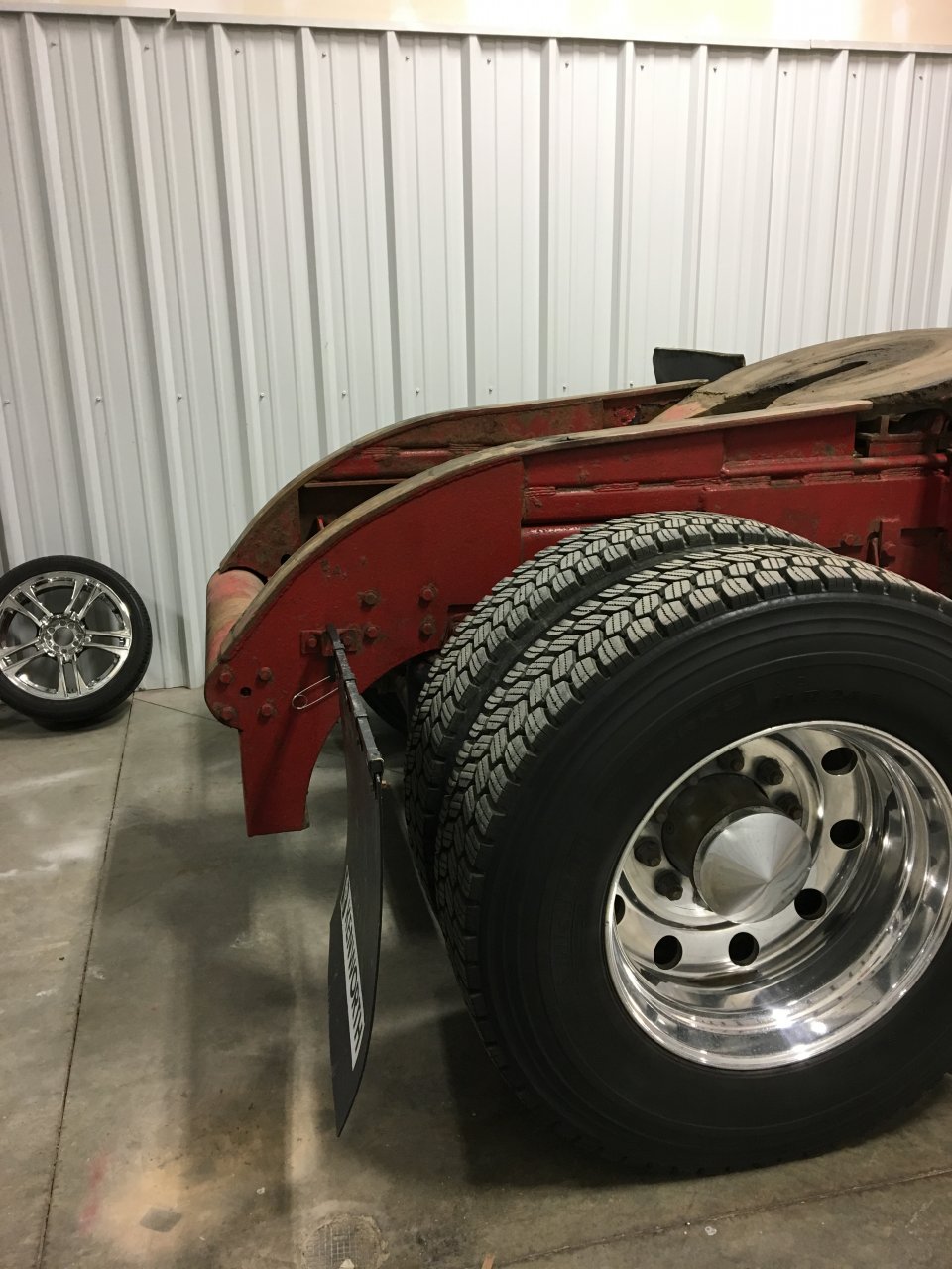

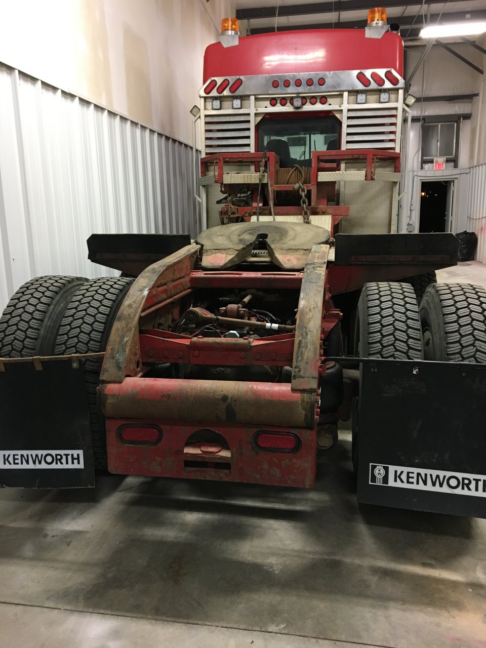

    IMG_0149.JPG IMG_0150.JPG Sorry I've been busy. Here's a couple pics of my setup.
