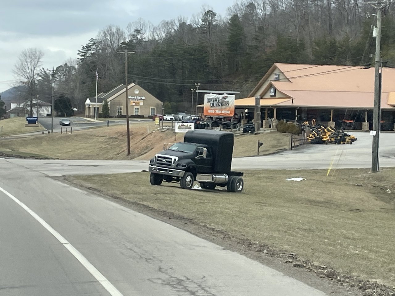

    Grab a toter truck similar to this and you won't have any issues.
    But if you can't find a good toter. Go after a ram 5500. They have sturdier frames than those whimpy 3500's & 4500's
