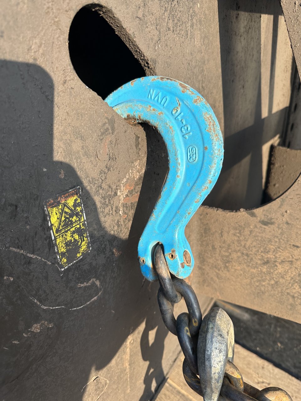

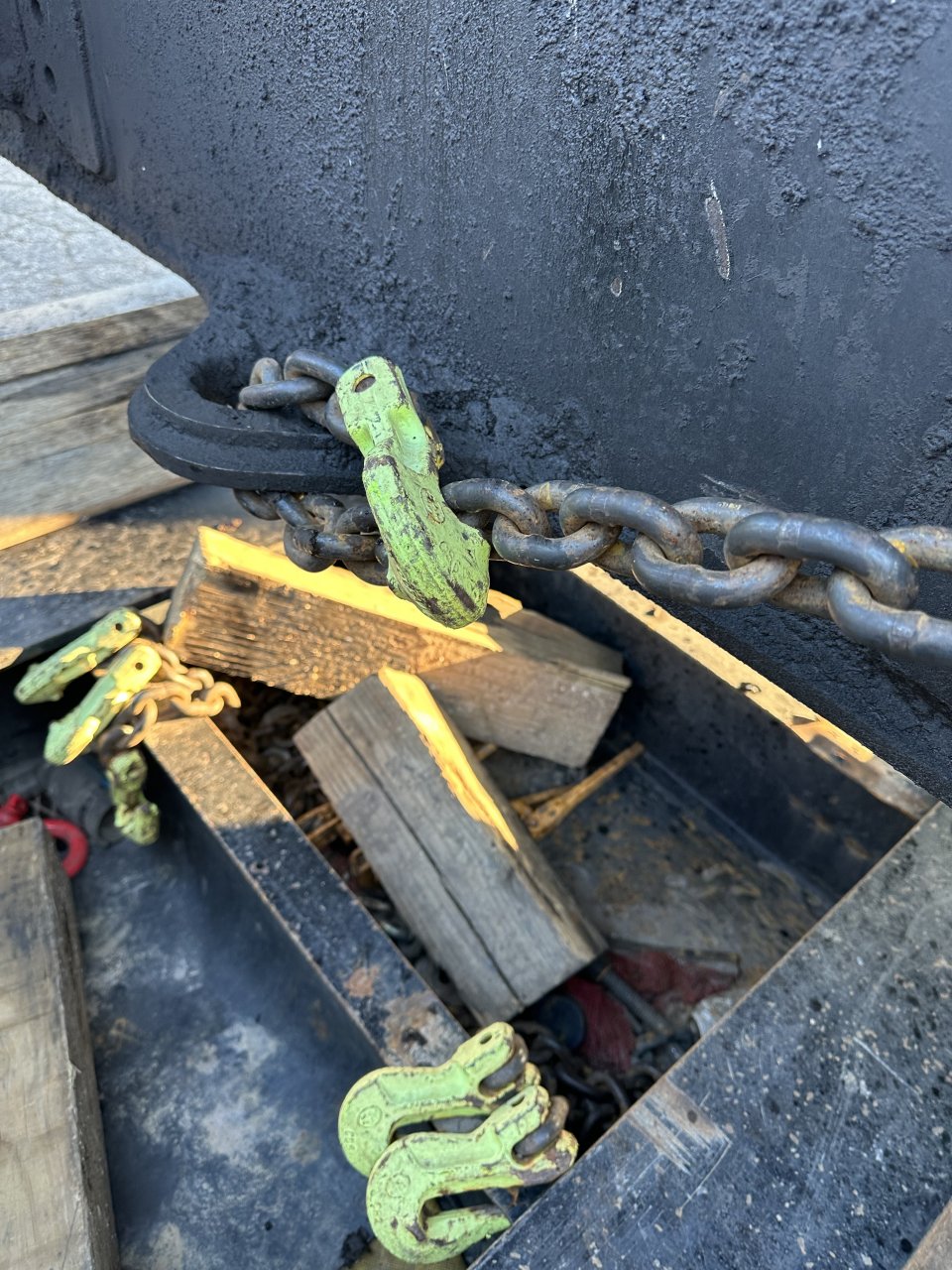

    IMG_0456.jpeg IMG_0458.jpeg To answer the OP question regarding foundry hooks here’s what I did.
    I bought grade 100 foundry hooks and took them to Ashely Sling in Charlotte NC and had them put them on 5’ lengths of grade 100 1/2 chain.
    I also had them make me the same with grab hooks.
    I have 6 of each and an assortment of long 1/2 & 3/8
    Find somewhere near you that builds rigging for overhead lifting and they can get you right. Yes it will be expensive but definitely worth it.

    I'm not arguing as I have grade 100 chains. But if a Grade 80 grab hook matches the WLL of a Grade 100 chain, why do you need grade 100 grab hooks? I suspect foundry hooks need to be grade 100 to match the 15,000 lb. WLL of grade 100 1/2" chain.

    How hard is it to attach the foundry hook to the chain…?
  7. Oxbow
    Oxbow Road Train Member
    13,706
    142,302
    Nov 24, 2015
    Just a couple of roll pins.

    I definitely agree..if you can spend less and get the same WLL then absolutely it makes sense.

    I forget, but we modify a lot of 1/2-5/8 binders with a slip hook directly on the end for that sort of stuff, usually carry at least 4. And there's two ways you can go about it, think we put 5/8ths hooks direct on binder
    But the other way we have done it is get a hook with an eye and use heavy duty twin link to attach to binder.

    I use foundry hooks on a couple 4’ tail chains. Grade 80 on grade 70 chain. Had no issues. They are a little speedy but very handy. I also have 4 binders with slip hooks on one end. Also spendy and handy.
    As far as a cheap alternative, I haven’t found one. And as far as grade 80/100 chain. It’s useless unless you are using grade 80/100 binders. My foundry hooks I got on a deal because some guy ordered them and didn’t realize how big they were.
