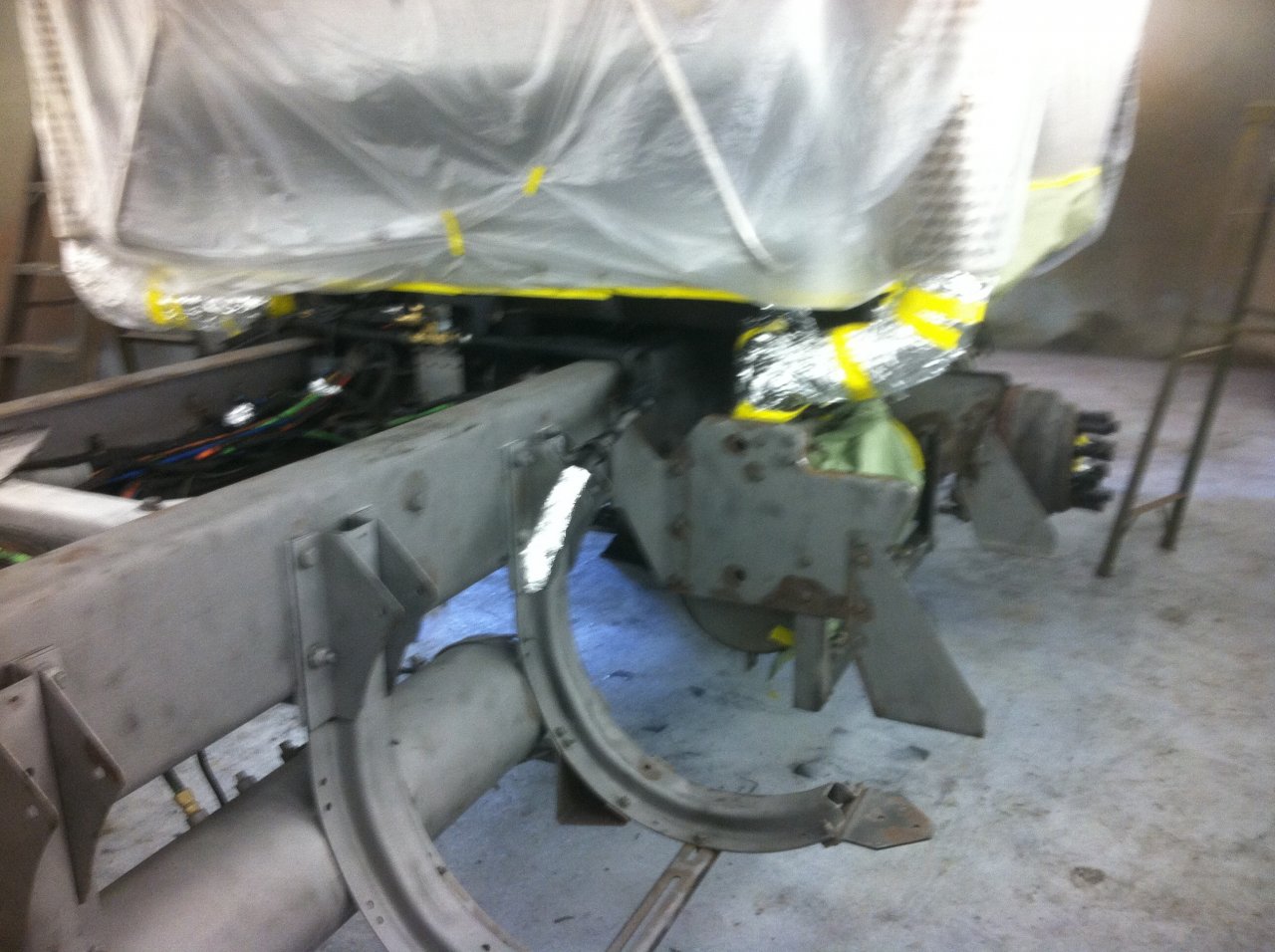

  8. Cat sdp
    Cat sdp . .
    21,303
    76,192
    Apr 8, 2012
    Orion's Belt
    5k..... Plus extras. Frame only , can hardly wait to do the cab :($:(
    rank and Ruthless Thank this.
