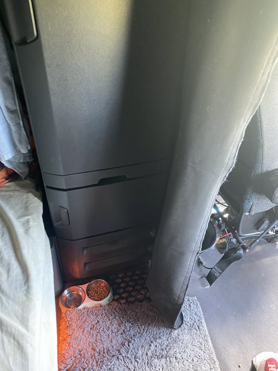

    Hey guys.
    i rented a brand new 2022 Freightliner Cascadia.
    Been driving it for 3 months now and doing good.
    The thing i noticed, the A/C in my sleeper doesn’t blow cold air, it just blows “cool” air and then if i crank it up it blows kinda hot air. The A/C in front works perfect.

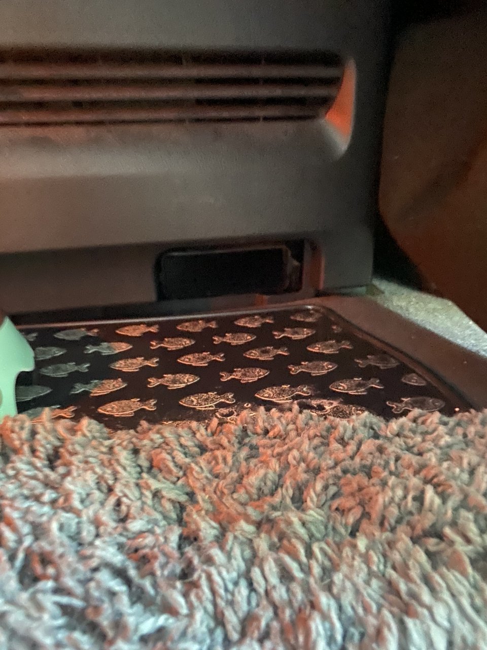

    The thing that is driving me crazy at the moment is valve underneath the cabins behind the drivers seat is blowing very hot air and I’m in Florida. I don’t know what to do about it.
    Here is the photos of the valve that is blowing very hot air even with A/C cranked all the way to the cold.
    What can i do about it? The summer is coming, can’t take it.
  3. Arctic_fox
    4,529
    25,632
    Sep 16, 2016
    Have someone check the A/C pressure levels. Could be the factory didnt put enough freon in to fully charge the lines or forgot to bleed them would be my guess and the easiest thing to rule out.

    Have you tried clicking the sleeper button on the AC control on the dash?

    As Dave said, try playing with that stupid sleeper button on the dash. It's a flawed system at best.
