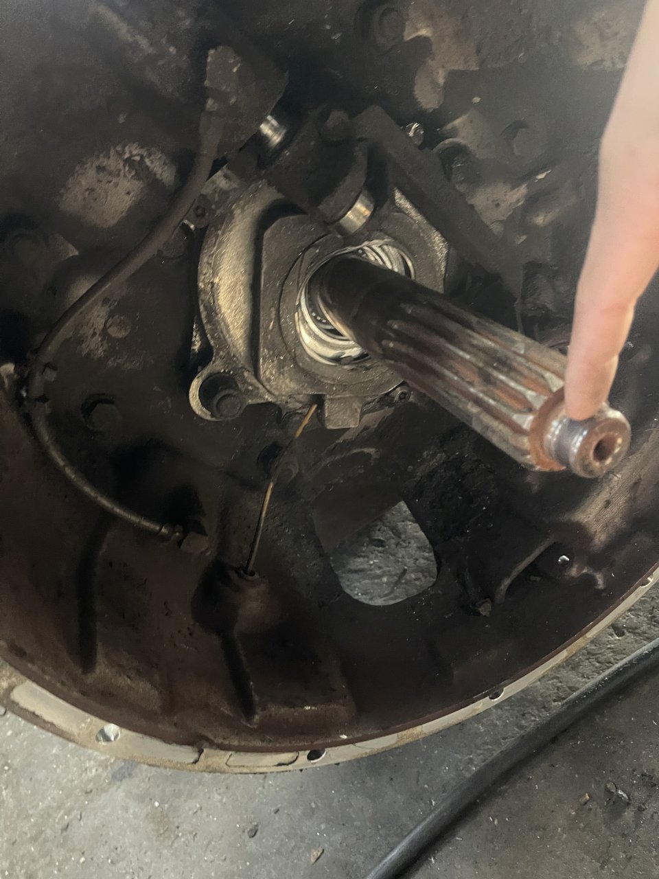

  10. Rae47
    Rae47 Bobtail Member
    5
    Oct 27, 2021
    Pic attached
  11. Goodysnap
    Goodysnap Road Train Member
    3,781
    9,221
    Jul 12, 2017
    Is that the old clutch? Throwout bearing is broken in two? Did the worn input shaft get replaced? FC 27 has reoccured with the new clutch?
    Oxbow Thanks this.
