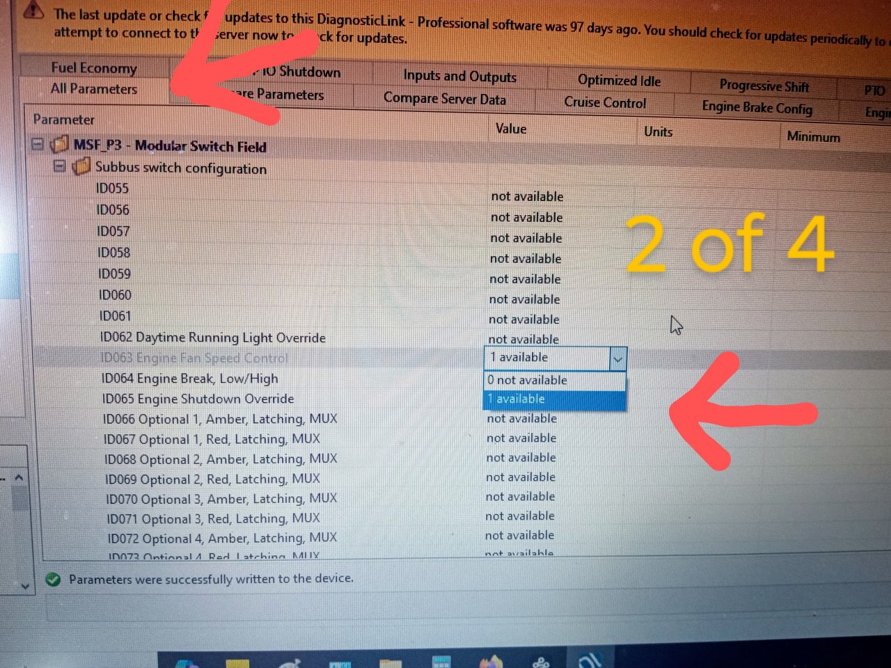

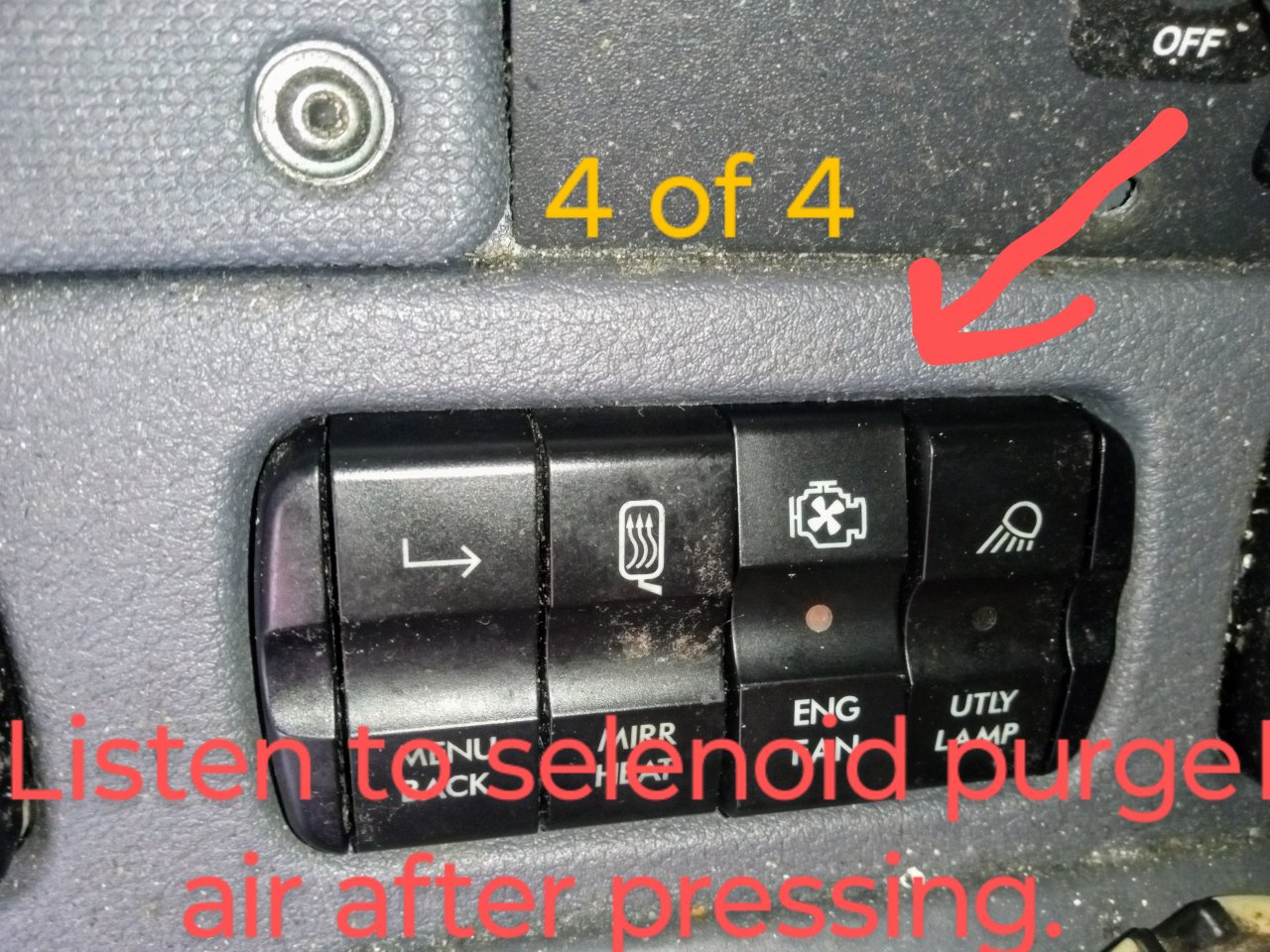

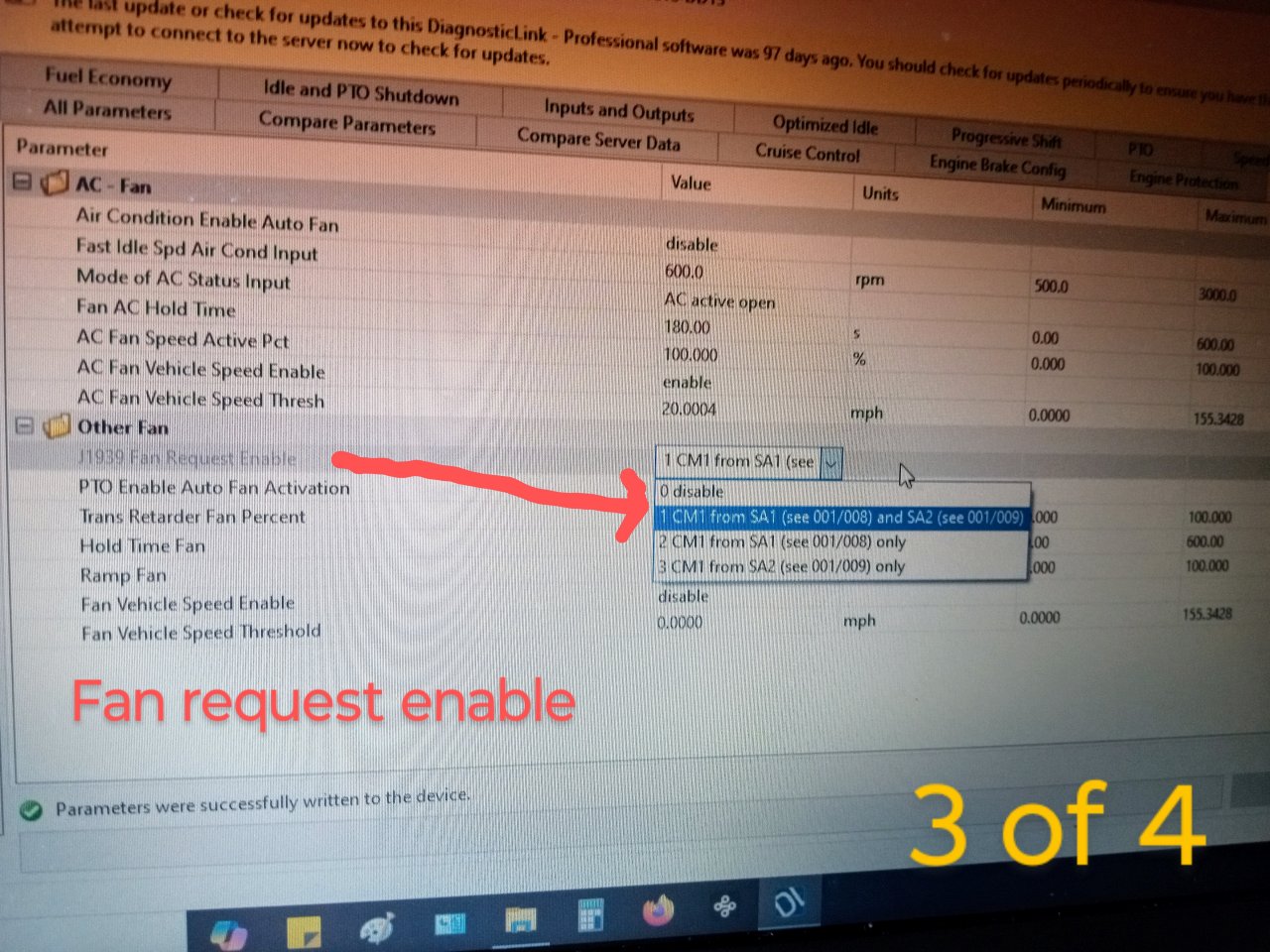

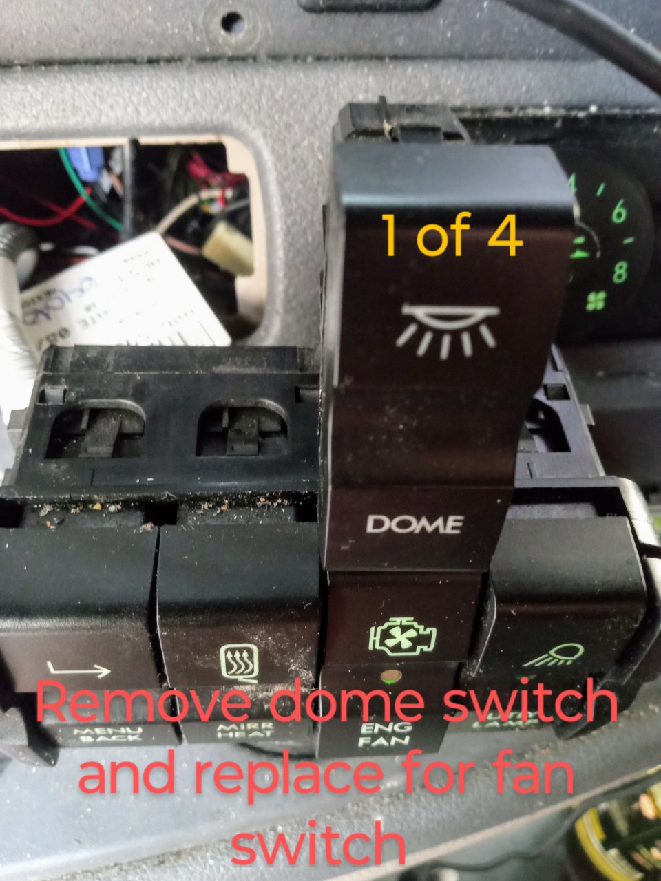

    Freightliner Cascadia engine fan switch installation tutorial.
    There was no available switch slot open, so the dome light switch was replaced for the new fan switch. Therefore, dome light switch no longer available on dash due to replacement for engine fan switch. After removing the switch the code dome light subbus switch missing will appear on diagnostic link software, but not as an active code. Try at your very own risk : )
    ***note***
    To confirm that the newly installed engine fan switch turn on and off few times while listening to the fan clutch selenoid purge air when activated and also feel the fan clutch actuating on and off as well.
    ***note*** Generic fan switch part number A0653782016. Don't forget to press the send parameters button after changing them on the detroit diesel diagnostic link software.
    Follow the images below 1 through 4. Good luck.
    IMG_20240912_155006225~4.jpg IMG_20240912_155212353~2.jpg IMG_20240912_155121637~2.jpg IMG_20240912_154844491~3.jpg

    I had to order the switch online. Premier couldn't find it in their system or from a VIN that has one. Have you had any luck in turning down the fan kicks on temp? I can't find it.

    Sure. It's under the parameters section under engine fan and cooling. Not on the tab fan section. On the parameters section there is first stage and second. Need to change both conserving the same temp range length ratio.
