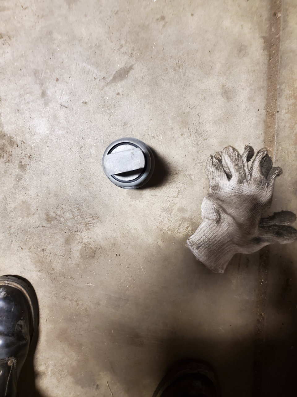

  7. MRMTRANS
    MRMTRANS Medium Load Member
    411
    441
    Apr 28, 2015
    Some dealers still have the old ones on the shelf. I'm getting ready to install this one as soon as I finish setting up a 20 ton shop press I purchased today.

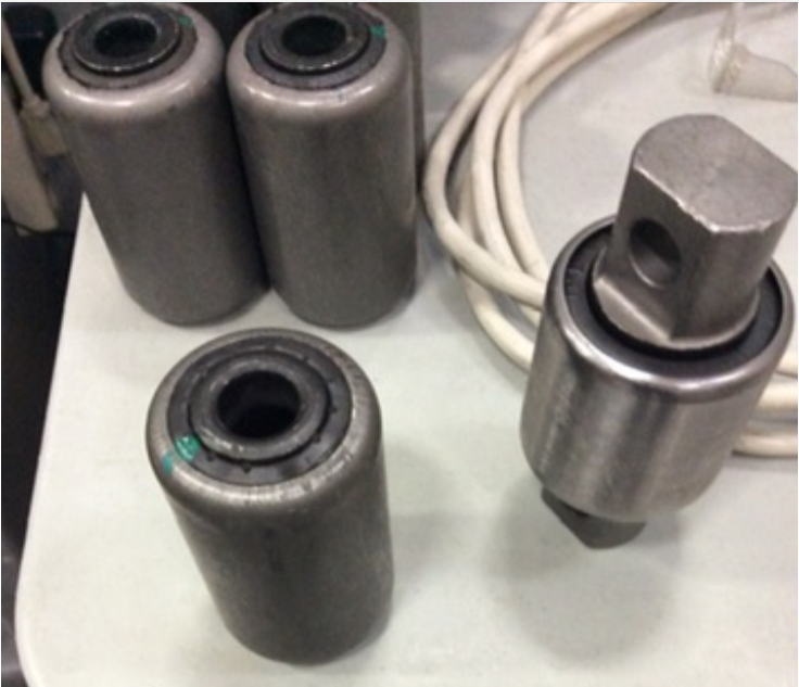

  10. RocketyMan
    RocketyMan Medium Load Member
    554
    337
    Jun 5, 2015
    Interesting....those bushing housings don't look as "shiny" as the green dot ones I have. I wonder if the shiny-ness was part of the more extensive corrosion protection. Like it was sprayed with lacquer of some sort.
  11. MRMTRANS
    411
    441
    Apr 28, 2015
    The one I pushed out was different than that one in the picture I pushed in.
