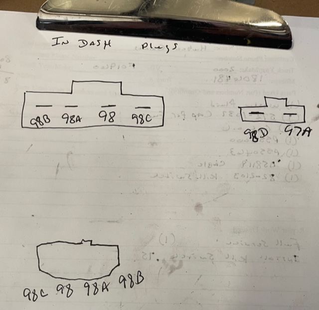

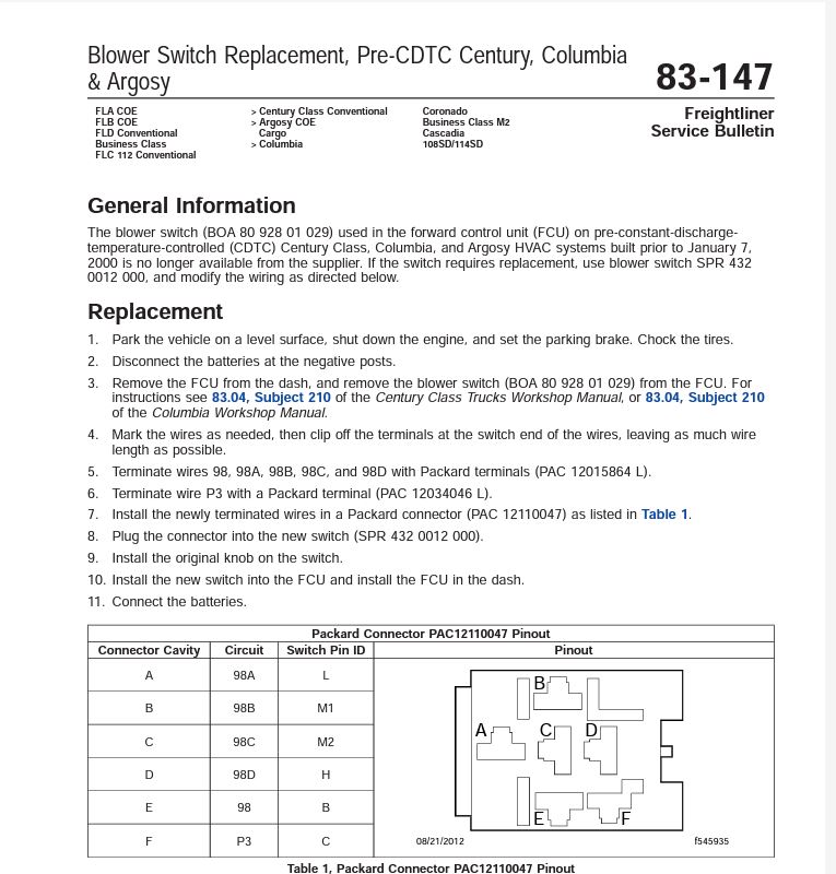

    Installing the replacement upgrade unit on a 2000 Century. The instructions say wire P3 goes to F on connector. I don't see a wire P3. There is one wire that had 97A on it that connected to the switch right above the yellow air line on the old unit. Not sure if that is correct or not.

    No replies to my post so I figured it out and made a video. Maybe it will help someone in the future.
