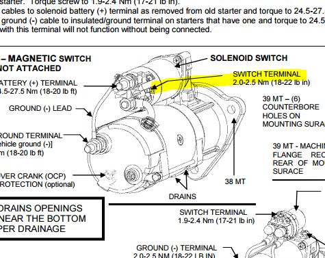

    If you remove the magnetic relay switch from a 39MT and it fails they will more than likely void the warranty. I had one they refused to warranty because of that, so now I make sure any 39 starters that are installed the switch stays on.

    The next time it clicks take a test light and put it on the highlighted area and try to start. If it just clicks and the test light lights up then the starter solenoid is bad. We usually replace the whole starter rather than just the solenoid.

    I have the 42mt. Does it go on the same? I replaced just the selenoid before and it was good for a week then clicked again, so I replaced the starter/selenoid and it was good for a week or two, started clicking again. That's when I ran the cable directly from the negative battery post and cleaned off all the ground cable locations. Was great for 2 weeks no issues, then it clicked again. It clicked one time and the second time I pushed the button it fired up. The only thing I haven't replaced is the long cable from positive to starter and the short negative from battery to frame. Also I found that whoever had the truck before me replaced the long positive cable and others, like the pigtail but never removed the old ones. When it clicks the starter never engages so something is happening in some type of relay before it signals the starter.

    That wire is the same on a 42.
