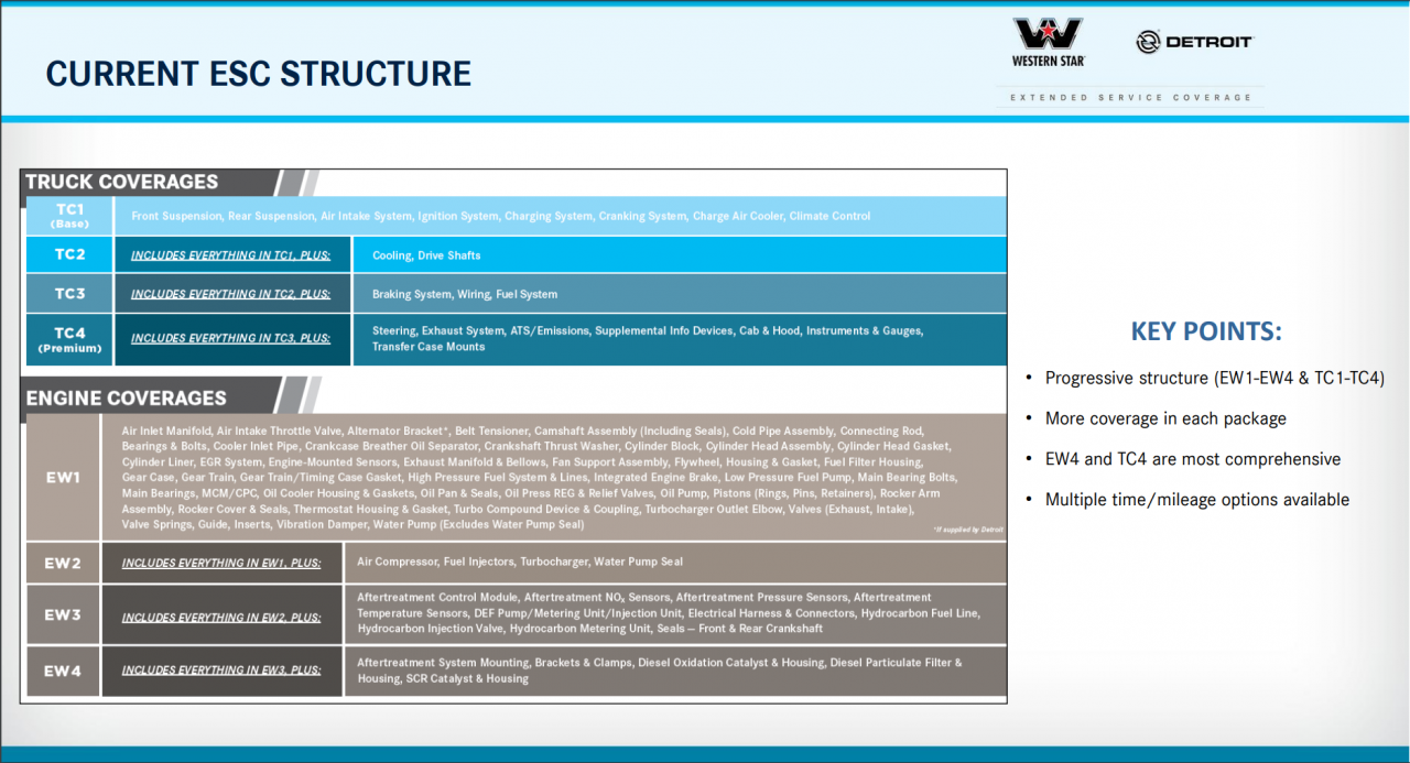

    Can someone explain the different warranties available for the Cascadia w/DD13 or DD15 engines?
    I'm looking at 2018-2023 used trucks and I see some showing EW3 warranty remaining, some with EW4 warranty remaining.
    My questions are how many different warranties are there? And what does each warranty cover?

    I've been searching a lot here and on FB and Google even. Apparently those extended warranties cover anything with freightliner part#. That's pretty inclusive I would think. I plan to have the warranty. I've never ran an emissions truck before, so I'll pay for the peace of mind. I don't mind downtime.. makes for more fishing!

    Post a S/N and I can show you what remaining coverages the unit has.

    Can you explain what the different coverages are? How many different warranties are there? I typically only see EW3 or EW 4 advertised but I'm sure there is more than that available?

    EW3 does not include the One-Box after the first two or three years.
    EW4 includes the One-Box up to five years

    See below.
