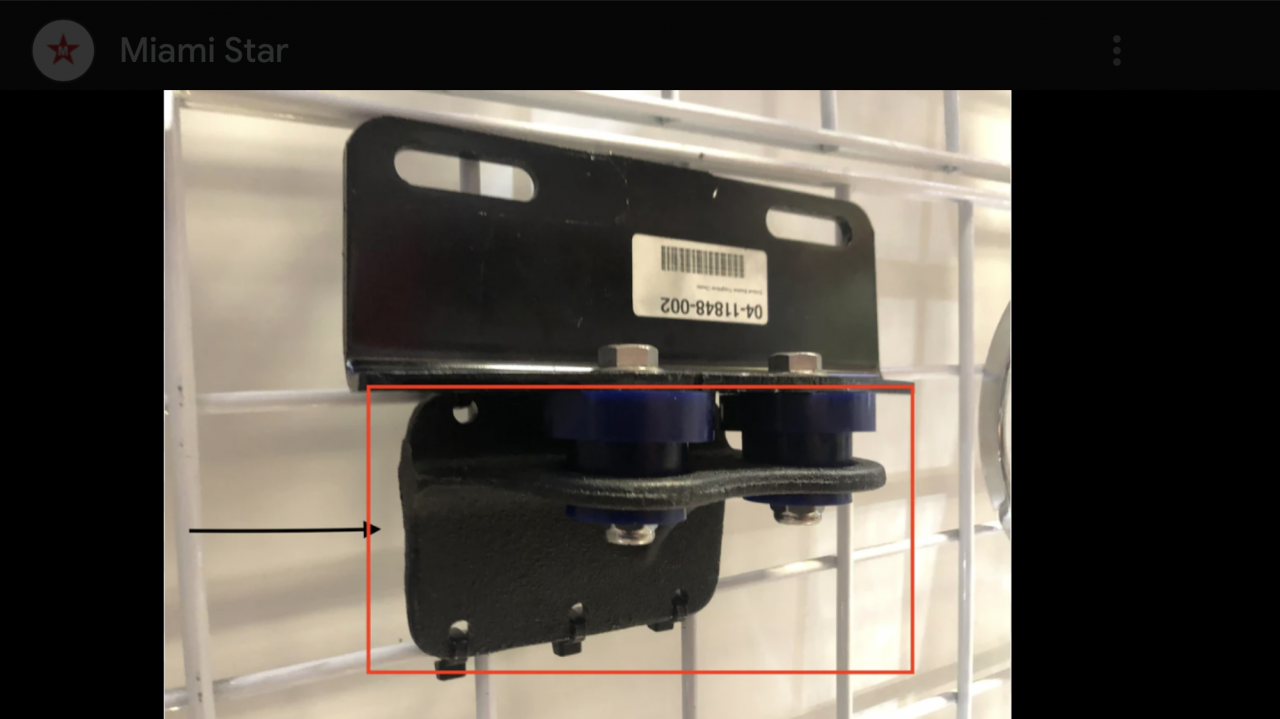

    Looking for part number for the exhaust cab brackets I got 94 fld 120 and it’s got single exhaust now and I’m trying to put stacks beside the door wondering if anyone has any part numbers for those cab brackets. Thanks!

    These? 530D6687-12B9-4D85-B177-7B2C11DFCA55.png A217349A-CF42-4CF0-B57C-CF7DD1BA376C.png
    Since most of the FLD 120’s had the stacks mounted behind the cab/sleeper it is best to find a classic of that vintage. The cabs are identical. The hoods and sba’s are the only difference.

    Yeah those are the ones I’m looking for you wouldn’t have a part number for them would you?

    The second pic has a part number on it. Thats a Freightliner PN.

    Thats why I posted it. Lol! That one is hanging up at the Freightliner house in town. Seems they sell a lot of them. I know they have been a hot salvage part for years.
