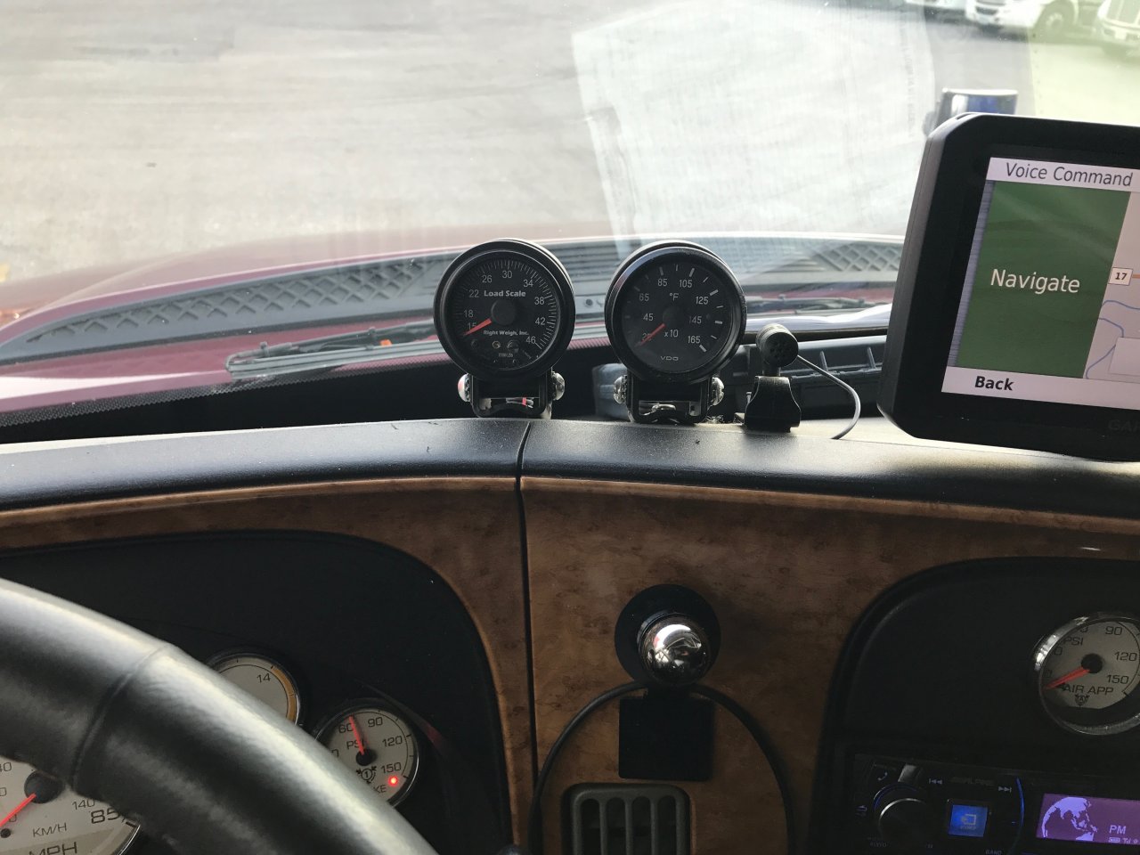

    I would install a pyro, at the very least. And you already know about the fuel pump.

    Considering where I can put it. My dash is full. I'll post some pictures of it when I go back to work. Might be a few days
