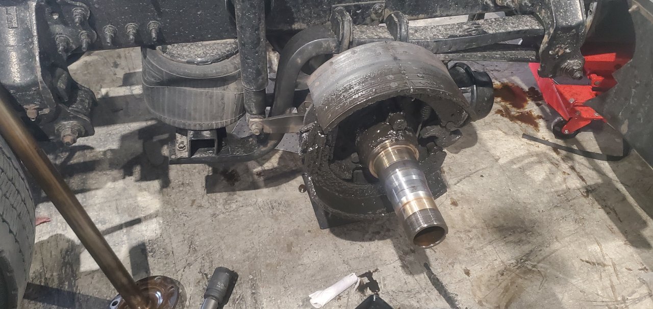

    $1500 is seals, brake shoes (completely coated in oil) and drums. Drums are near DOT spec.
    As far as time, already have a week into this garbage. Like all of us, have to get back on road.

  5. AModelCat
    29,853
    166,504
    Where was the damage on that ring gear? I didn't really see anything there that was concerning.

  6. jamespmack
    I would question this to. I could understand installing a bearing kit as proactive and a very close inspection. Pretty low milage for a replacement. Shoes, drums and wheel bearing are a given.

  7. AModelCat
    29,853
    166,504
    Pattern looks ok and that frosting is normal. Unless there are pieces missing, large pits, cracks or evidence of spalling I see no reason to condem that gear.

  8. jason6541
    jason6541 Road Train Member
    2,425
    5,368
    Mar 5, 2012
    Omaha, NE
    Your right,
    Think dealer is a bit ambitious to sell a new Diff. Truth be told they will probably clean it up check the bearings and pinion depth and reuse it while they charge you for a new one. Shyster dealers will do that and have caught it done in the past.
