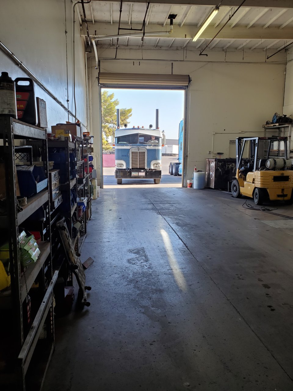

    I thought of you when Dave at Arizona Laser Alignment pulled this out this morning.
    3406a / 18speed / 320 WB
    AModelCat Thanks this.

    #### nice truck right there.
    Mine had a 12v92 15 double over and wasnt nearly that long.
