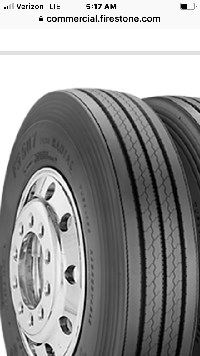

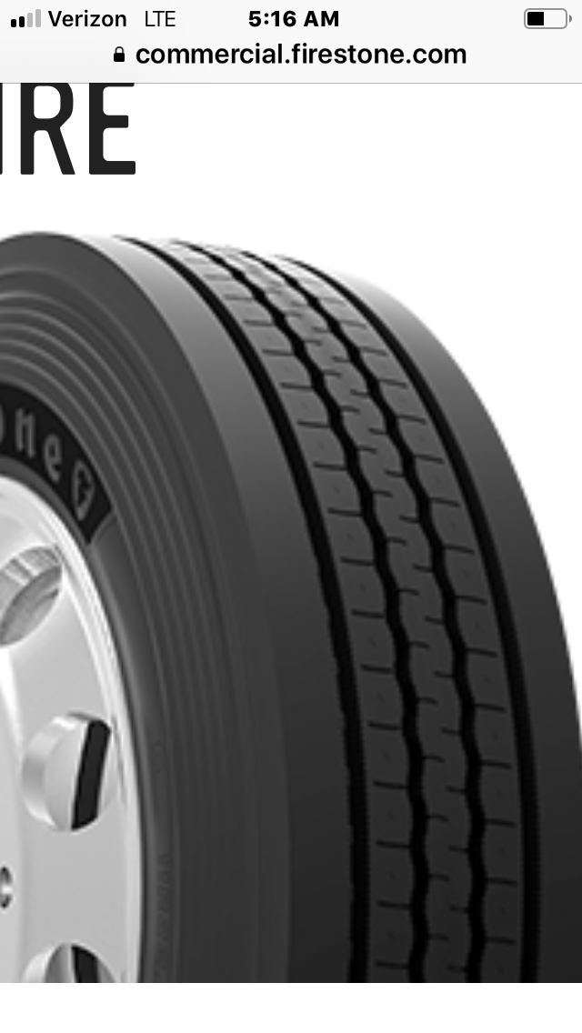

  8. Rideandrepair
    17,562
    56,898
    Aug 8, 2015
    0AA4DB2C-9FD3-4A4D-99E6-65908E612D85.png 67D2E37D-4977-4511-A419-D8A9C811703A.png
    With and without, both are steers

  10. starmac
    starmac Road Train Member
    6,639
    12,528
    Apr 11, 2019
    Fairbanks Ak
    That is what I was thinking, I just never called it a groove, and for my use actually would prefer not to have them, it seems like gravel will sometimes chunk them out, but not bad enough to have ever been a real problem.
