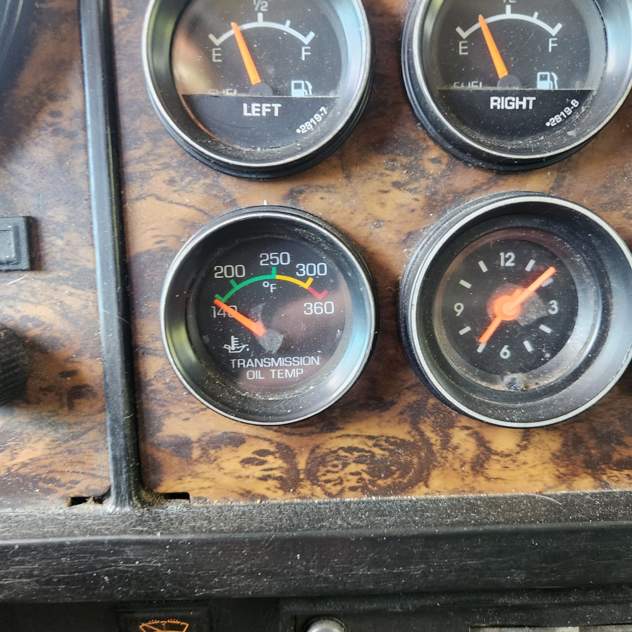

    And go with an air cooler, lose the coolant one. This gauge is correct

    Correct for what? that's too low of a temp, it should be at least 150ºF.
