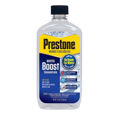

    Prestone, walmart $3.00, works so good it will keep your wipers clean in a blizzard.

    I use to buy this stuff at AutoZone and used it on them deep freeze trips. I'm sure other stores sell it, maybe even Walmart. It's good to -34 degrees. I never had a problem. The company reimbursed me too. Just put it on a separate receipt.
