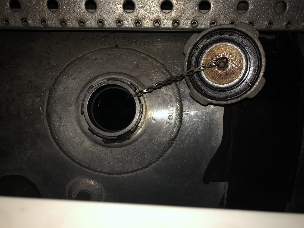

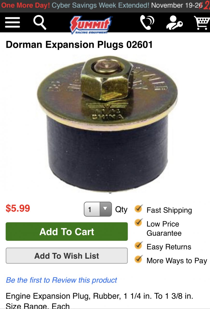

    Here’s what I used.
    It’s a rubber frost plug you can buy in any parts store.
    I drilled the bolt that sticks out from the frost plug after tightening the nut.
    I then used a key ring to attach the chain to the cap.
    The picture of the cap and chain I just took now and you can see it is still holding up well with zero leaks.
    Also plug in the picture is not necessarily the exact side you need.
    You need to measure your hole and purchase accordingly.
    If I can be of any more help just let me know.

    Is the plug in the picture you sent the one you used?
  4. Hulld
    Hulld Road Train Member
    2,884
    6,568
    Oct 19, 2015
    Upstate NY
    Not sure on what the exact size I used is.
    Take your cap with you to the parts store and get the appropriate size.
