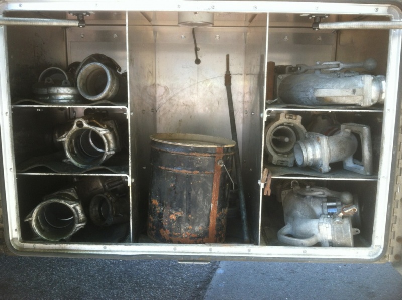

    Nice set up here..... Top left misc fittings. Elbows everywhere . Middle compartment bucket, pry bar etc.

    That's very nice and organized. However, I think I'd have a rubber matting under the fittings just so they don't bounce around.
    How many gasoline haulers are out there that use plastic buckets? I've seen some come into the rack to load and when they did we would tell then there's a good chance you'll get burned.

    And dont forget when you use a metal bucket, you have to remove the little plastic roller on the metal wire handle. This can also conduct static. Small chance, but why risk it.

    Exactly! How many times have you been unloading when someone pulls up and starts filling a gas can in the back of his bed lined pick-up?
