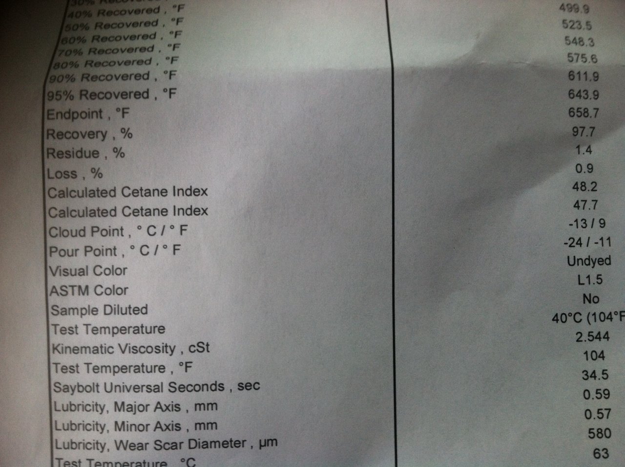

  10. Cat sdp
    Cat sdp . .
    21,313
    76,271
    Apr 8, 2012
    Orion's Belt
    This is a spec sheet for my fuel suppliers summer ulsd.....
    Cloud point 9F......
