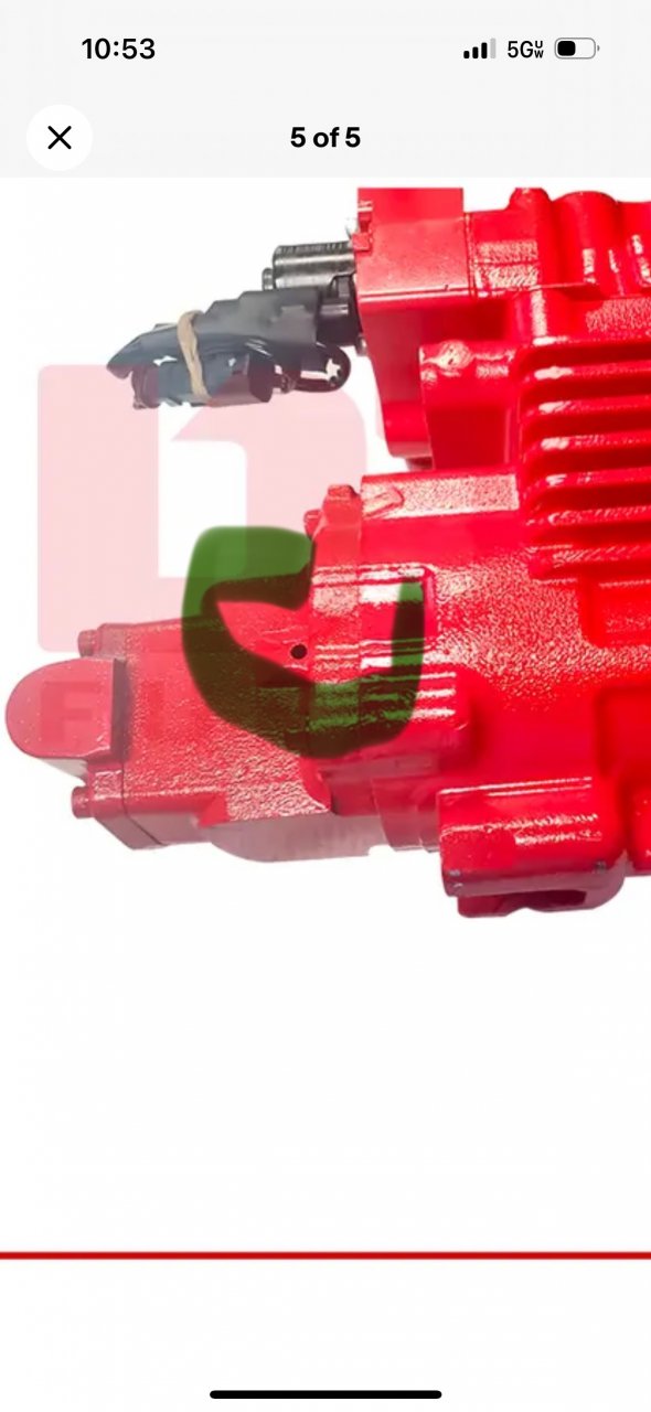

    I’m stuck on the hwy leaking fuel from the fuel pump. Is there a plug that goes in that little whole? 2015 Cummins isx

    I would say its time for a new pump. That hole looks like a weep hole to let fuel out when the seal fails. Kind of similar to a weep hole in a water pump.

    Thanks ya that’s what the mechanic said time to call a tow truck
