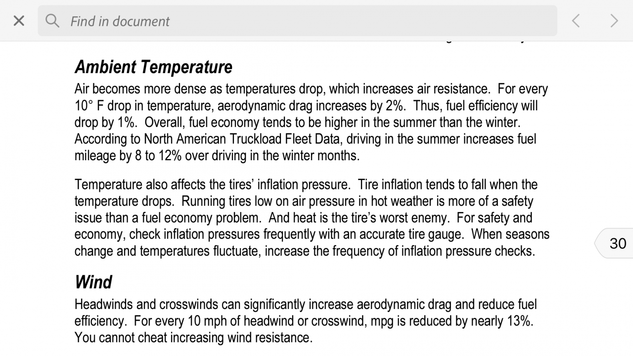

    Speed, load weight, cold ambient temperature, and wind speed are some of the big factors in MPGs.

    If the tractor in your Avatar is the one you are pulling a van with then the height difference of your tractor roof and trailer is part of your problem. If you own the trailer a nose cone could solve that. Google tractor trailers with aerodynamic devices and effects of wind resistance on fuel economy and you can research numerous studies that have been tested. Some sites explain the different options on semi trucks and what percentage they play in fuel economy gains.
