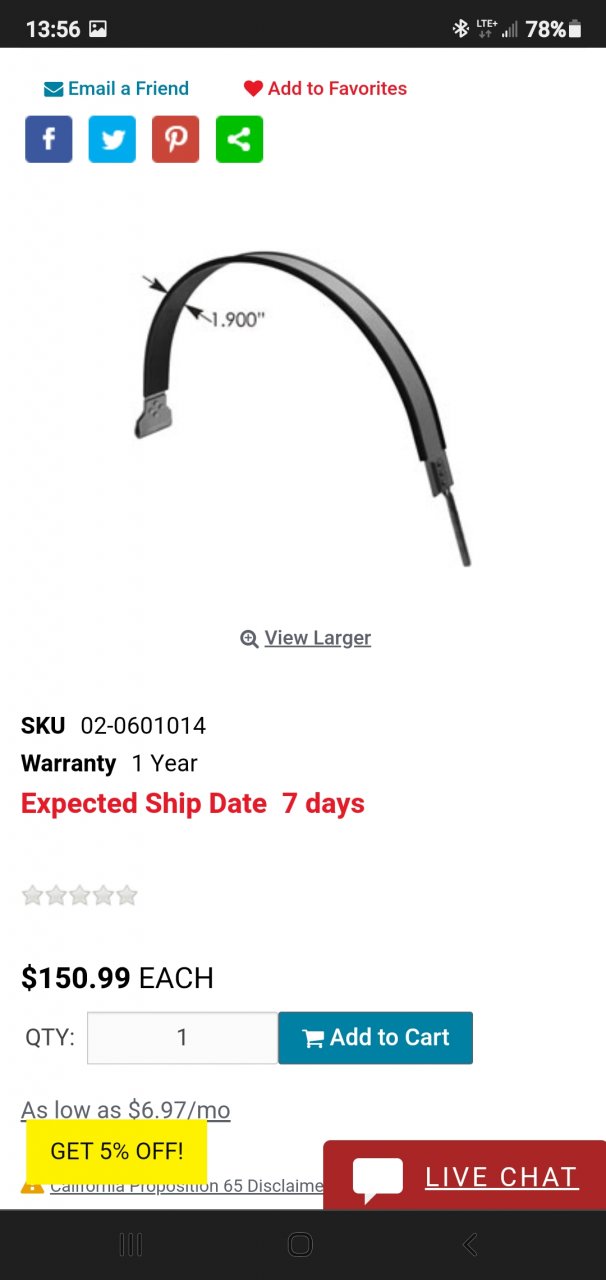

    When you say wide band, you mean wider than the 2 inch standard one that everywhere seems to think 150$ each is a good price on?
    At that price i will certainly be making my own straps, what is the relative benefit beyond looks for a wider strap? As i understand it, it is primarily to hold DOWN the tank not up, and the ends still seem to be 2 inch and then the single t bolt so im not quite sure why i would go wide band.

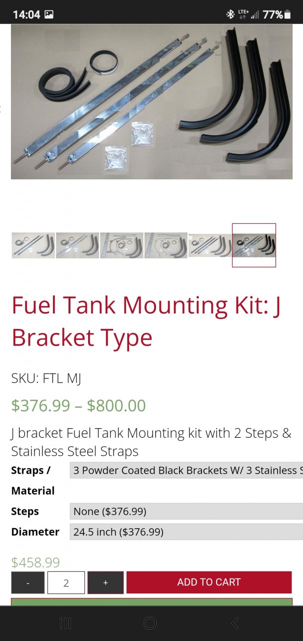

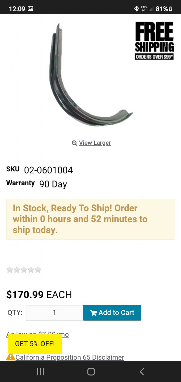

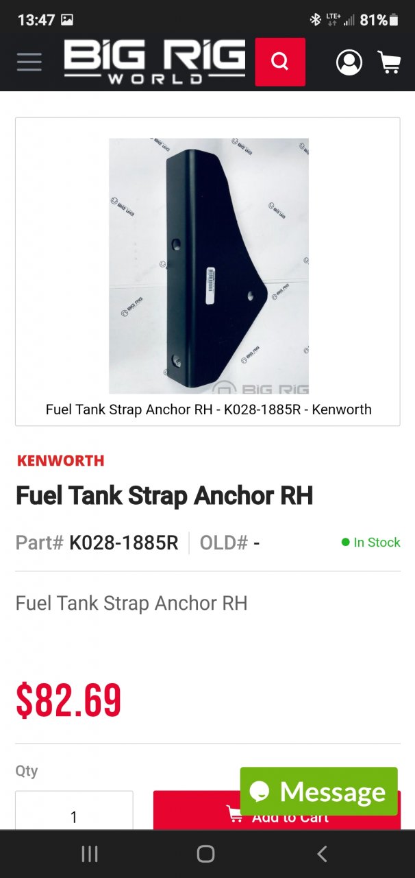

    6 of each and 6 more of the lh strap anchor....
    2924.16$ before i even look at tanks... wtf?
    VERSUS
    2 of these kits
    Plus 200$ shipping
    Taxes putting it near 1200$
    Can anyone convince me of the wisdom of buying either oem replica or aftermarket instead of just having my dads shop plasma cut the parts and weld assemblies for a custom setup?
