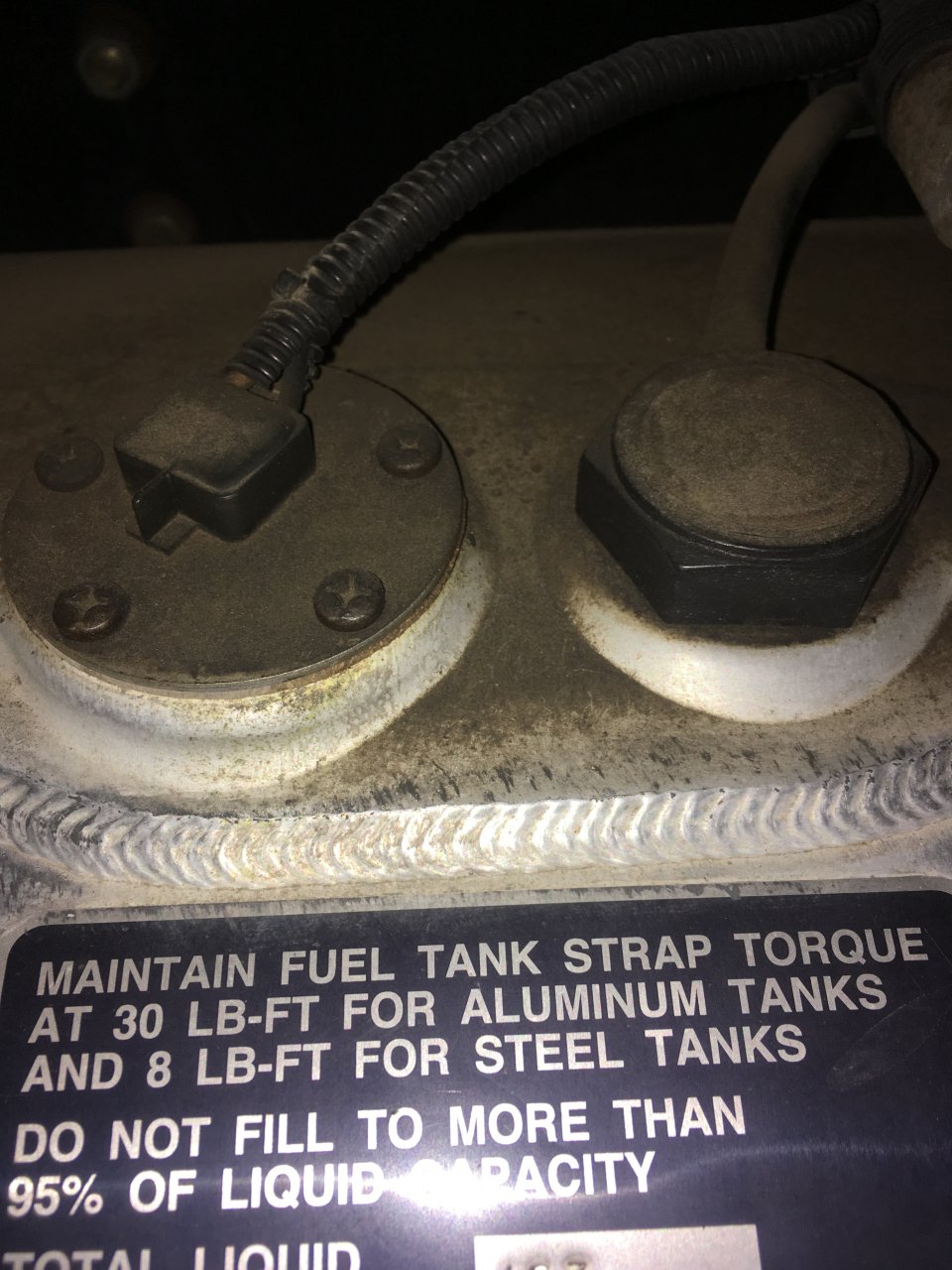

    there is a torque spec. our tanks had the spec imprinted in the tanks by the cap. but i cant recall them. 8LBs for steel straps and 30 for alumy...?

    @Ristow is correct. Here is a pic from a sticker off my truck.
