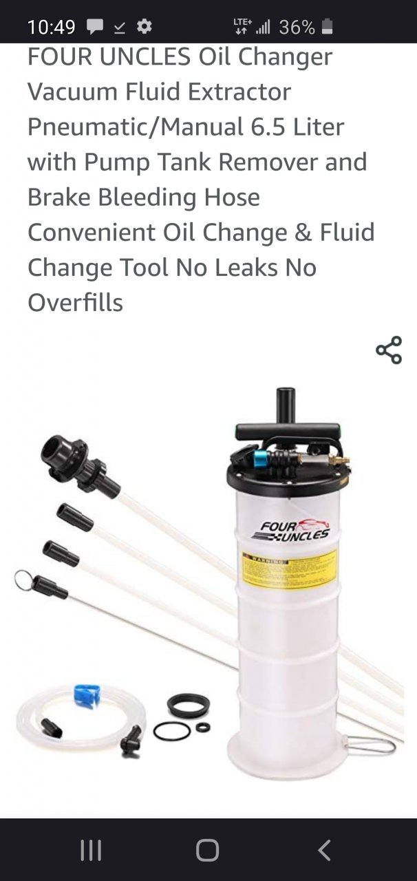

    Works well for fuel tanks or anything else you need to evacuate for sure
